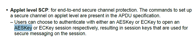

Kan_Li
Hi @psvz ,
An AES key can also be used to authenticated a user session, please kindly refer to the following for details.
and you may use the following API for that purpose.
Hope that helps,

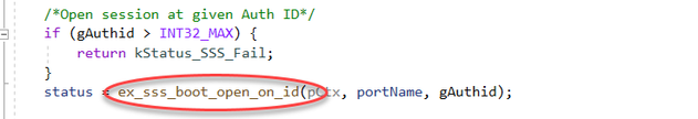

Kan_Li
Hi @psvz ,
If you want to use ex_sss_boot_open_on_id() to open an AESKey session, you have to build the MW with Auth_type=AESKey, to allow this API to take the Auth ID. Please refer to ex_sss_boot_se05x_open_on_Id() for more details, in which the host key store would also prepare the AES key as well.
Kan

Kan_Li
Hi @psvz ,
Yes, I agree Symmetric authentication model requires authenticating party to present the key, but that doesn't mean it allows the host to read the symmetric keys stored within the SE, if it allows , any user may authenticate with the SE. so from host side, it has to set the key value in the host key store for the AES authentication. If you use ex_sss_boot_open_on_id(), it calls ex_sss_se05x_prepare_host_keys() for that purpose. You may find it in ex_sss_se05x_auth.c
Hope that helps,

Kan_Li
Hi @psvz ,
The CreateSession command always needs an Auth ID to create a session, and that is why ex_sss_boot_open_on_id() needs an Auth ID as one of its inputs.
For your compiling issue, I am not sure if you write your application from scratch or based on some MW demo, but since you set PTMW_HostCrypto as OPENSSL, why include the mbedtls folder in the building?
Kan
