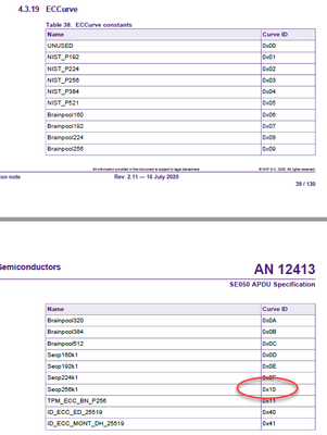

I'm working with an Arduino Portenta C33 and am facing a challenge related to its integrated SE05X security element. The current SE05X library allows for the generation of ECCurve_NIST_P256 key pairs (https://github.com/arduino/ArduinoCore-renesas/blob/main/libraries/SE05X/examples/SE05XPrivateKey/SE...), but I need to generate a key pair using the SECP256K1 curve. Does anyone have example code or tips on how to solve this problem?

Hi @MaxMustermann84 ,
I think you have to find the curve type definition in the SE05X Library on Arduino Portenta C33 and change it from ECCurve_NIST_P256 to ECCurve_SECP256K1. Please kindly refer to the following for more details.
