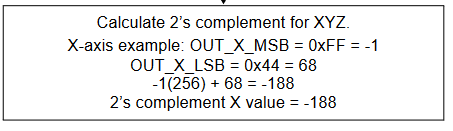

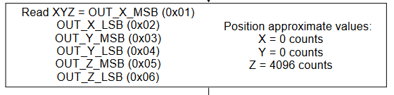

I'm trying to doing the Aut-Calibration Procedure of the device.
yes, I have already read the AN4069 note :smileyhappy:
On page 6 of the note there is an example using a flow chart.
I didn't understand the 3th box:
Have I to read, (and so print?) the acceleration on X,Y, and Z using firstly the register OUT_X_MSB?
After that have I to read the acceleration on X,Y, and Z using the register OUT_X_LSB?
After that have I to read the acceleration on X,Y, and Z using the register OUT_Y_MSB? etc?
4,183 次查看
luigi5hd
I've tried to do as I mentioned and my Acceleration values are these:
first line X,Y,Z using OUT_X_MSB
second X,Y,Z using OUT_X_LSB
third X,Y,Z using OUT_Y_MSB
fourth X,Y,Z using OUT_Y_LSB
etc.
Are these the values that I need to use in the next step, for the 2's complement?

TomasVaverka
Hi Luigi,
Sorry for my late response. I would recommend you to take a look at my simple example code for the MMA8451Q where I illustrate offset calibration based on the AN4069.
You should use something like this:
I2C_ReadMultiRegisters(MMA845x_I2C_ADDRESS, OUT_X_MSB_REG, 6, AccData);           // Read data output registers 0x01-0x06
Xout_14_bit = ((short) (AccData[0]<<8 | AccData[1])) >> 2;           // Compute 14-bit X-axis output value
Yout_14_bit = ((short) (AccData[2]<<8 | AccData[3])) >> 2;           // Compute 14-bit Y-axis output value
Zout_14_bit = ((short) (AccData[4]<<8 | AccData[5])) >> 2;           // Compute 14-bit Z-axis output value
Xoffset = Xout_14_bit / 8 * (-1);        // Compute X-axis offset correction value
Yoffset = Yout_14_bit / 8 * (-1);        // Compute Y-axis offset correction value
Zoffset = (Zout_14_bit - SENSITIVITY_2G) / 8 * (-1);          // Compute Z-axis offset correction value
I2C_WriteRegister(MMA845x_I2C_ADDRESS, CTRL_REG1, 0x00);             // Standby mode to allow writing to the offset registers
I2C_WriteRegister(MMA845x_I2C_ADDRESS, OFF_X_REG, Xoffset);
I2C_WriteRegister(MMA845x_I2C_ADDRESS, OFF_Y_REG, Yoffset);
I2C_WriteRegister(MMA845x_I2C_ADDRESS, OFF_Z_REG, Zoffset);
Hope it helps!
Tomas
What are you doing with this shifting?
Is this equivalent to a 2's complement for XYZ no?
And are they approximated as integers no? ("short" operator)
