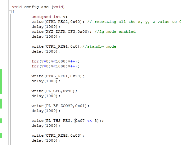

I have configured my FXOS8700CQ to give an interrupt at pin 1 whenever there is a change in orientation.I am receiving the interrupt at pin 1 but the interrupt flag once set is not getting cleared as debounce counter(PL_count) is not decremented can you just look into the problem,I have done all the configurations as mentioned in NXP
application note AN4068.
here's the configuration part of the code:

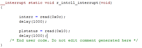

here's the interrupt service routine:
The problem is I enter the ISR and read PL status and interrupt source register but after that the debounce counter is not decrementing.

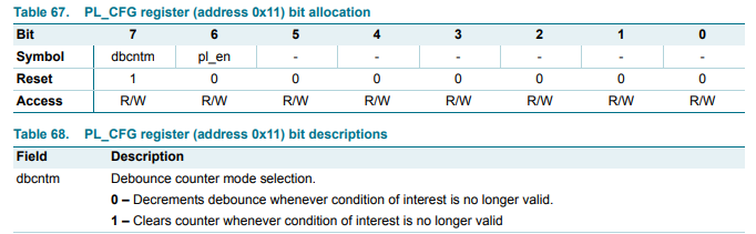

The behavior of the debounce counter can be set in the PL_CFG register using the dbcntm bit:
To clear the src_lndprt interrupt status bit in the INT_SOURCE register and consequently deassert the INT1 pin, it is necessary to read the PL_STATUS register as you are doing correctly.
However, it is also necessary to acknowledge an IRQ in your ISR by writing a logic 1 to a specific bit of your MCU. Without doing it, the interrupt flag on your MCU will remain active and then you are not able to receive any further P/L interrupts from the FXOS8700CQ.

I have already tried setting the dbcntm bit to 1 for clearing the counter
whenever condition of interest is no longer valid . Still the interrupt bit
is not re setting to 0 whenever orientation comes back to it's original
position.
