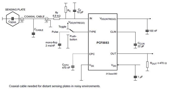

We are using the PCF8883 capacitive sensor and have been experiencing a lock up state I couldn't find mentioned in the datasheet/app note. If the sensitivity of CPC is set closer to the upper limits or the sampling frequency is increased, the sensor can be put in a state where a sense event triggers and the output remains high forever after. The type pin is grounded (pushbutton mode), but the capacitive event should clear when your hand is pulled away. This lock up does not occur with middle range CPC and CLIN values. We are trying to push the sensing distance out as far as possible, so there may be an increased susceptibility to noise, but it only seems to lock after a sense trigger. I am just wondering if anyone knows what might be the root cause.

david_diaz
Hello Stephen,
Thank you very much for writing.
Please find the typical application design with default values below. I recommend using it as a reference for your design.
I hope this information will be useful for you.
If I misunderstood your question, feel free to let me know.  I will be glad to help.
Have a great day.
David Diaz.

magicmicros
So, RTFM. Yes, thank you very much, have done that many times, our board is based on this circuit and with the given values.
It this all the "help" we can get from NXP regarding the undocumented lockups and other strange behavior?
