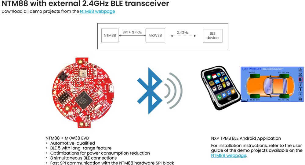

SooYuanChang
Do NXP have single chip solution BLE+TPMS chip ?
Example ,
BOSCH, SMP290
TI, CC2340R2
3,142 Views
TomasVaverka
Hi Yuan,
Currently NXP does not offer a single-chip solution that combines both BLE and TPMS functionalities.
As you may know, we offer the NTM88, a highly integrated tire pressure monitoring sensor that combines a pressure sensor, microcontroller, RF transmitter and accelerometer within a single package. However, this device does not include BLE functionality.
Having said that, we can offer a demo project combining the NTM88 TPMS chip with the MKW38 2.4GHz MCU. In this demo, the TPMS chip periodically takes measurements and transmits the sensor data to the MKW chip via SPI, which then transmits this sensor data via BLE to the smartphone. For more information, please refer to the attached NTM88+KW38 BLE Beacons Demo User Guide.
BRs, Tomas
