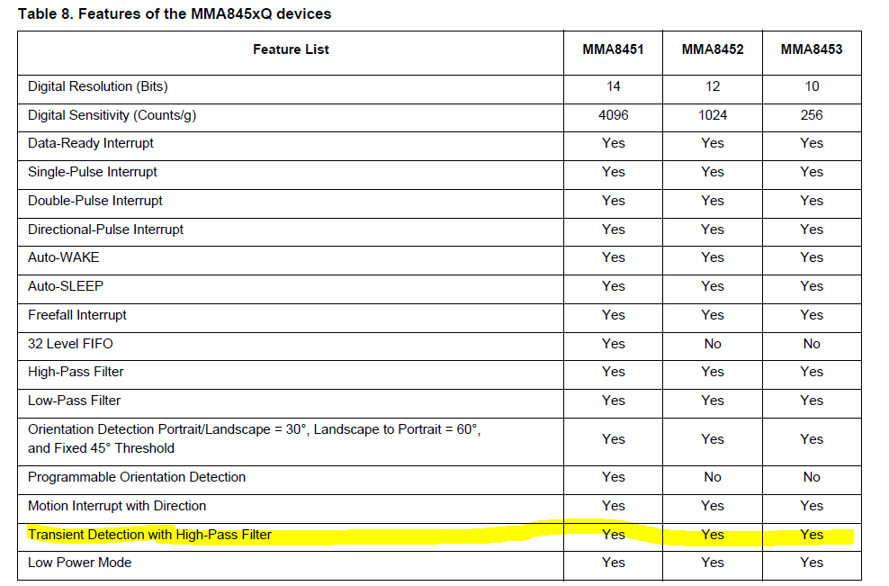

I suggest you to use (only) the Transient Detection with High-Pass Filter feature embedded into the MMA8451Q:
The high-pass filter will remove all acceleration offsets as the 1-g earth gravity.
Anthony

anthonyduhamel
Sorry but I'm a little bit confused... Do you need a motion detection OR a tap detection OR both? Can you share with me you configuration (I mean the code to initialize the MMA8451Q)?
Quick configuration for the motion detection:
RegisterValueComment
CTRL_REG1 (0x2A)0x00Set the MMA8451 into STANDBY MODE
CTRL_REG2 (0x2B)0xXXYou chose
CTRL_REG3 (0x2C)0x40Enable Transient function on an INT pin / INT active low/ Push-Pull
CTRL_REG4 (0x2D)0x20Enable Transient function
CTRL_REG5 (0x2E)0x20INT pin routed on INT1 pin (can be changed to 0x00 if INT2  pin)
TRANSIENT_CFG (0x1D)0x1EINT flag latched/ Enable 3axis detection/ HPF linked to the Transient function
TRANSIENT_THS (0x1F)0xXXDepends on the sensitivity needed for detection (0.063g/LSB)
TRANSIENT_COUNT (0x20)0xXXNumber of TRANSIENT events catched after send interrupt
HP_FILTER_CUTOFF (0x0F)0xXXSelect the filter cutoff here
CTRL_REG1 (0x2A)0b00XXX001Replace XXX by the needed data rate / Put the device into ACTIVE MODE
Anthony
