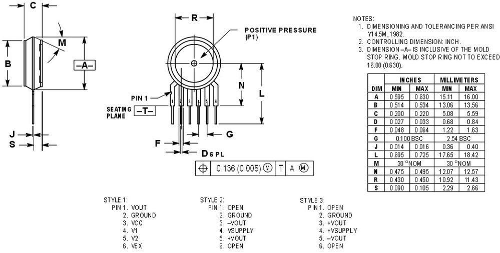

Please provide recommended land pattern for MPX4250AP. Your datasheet has incomplete dimensions. I need the resolution and updated datasheet soon. MPX4250AP-1.png

Hello Marvin,
In this case, it is the part of UNIBODY package from here​.
The information that you requested would be obtained as follow (using the max values in mm):
‘C’ - ‘S’ – ‘J’ = 5.59 - 2.66 - 0.40 = 2.53 mm
I hope this information will be useful for you.

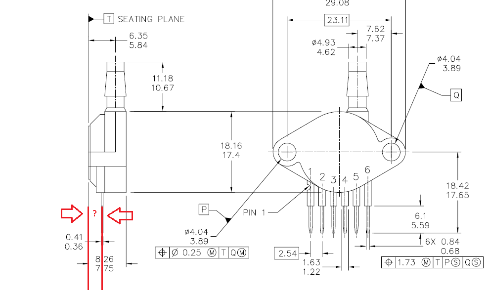

marvinbatalla
Hi, David. You're pertaining to 867-08(page 8 of the datasheet) and not 867B-04 (page 9 of datasheet). If you confirm that they are the same then your answer is correct. Otherwise, please provide updated datasheet with the missing dimension. -Marvin

david_diaz
Hello Marvin,
My apologies for the delay.
Indeed, the information mentioned before is useful for you.
In this case, the port adapter is the difference between the dimensions.
If I misunderstood your question, feel free to let me know.  I will be glad to help.
