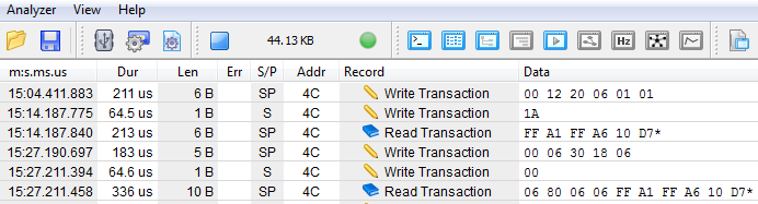

Below is a comparison of the legacy/normal modes, still based on current example (settings are the one I already provided).
I simply halted the device before (command W00 12 20 16 01 01) to froze the AFE data.
IIC WRITE TRANSACTION :: Starting MB = 00
Write : 12 20 06 01 01 // enable sleep mode (STOPNC) in Sleep-Wake Application
Quick-read Mailboxes, legacy mode
IIC READ TRANSACTION :: Starting MB = 1A, No. bytes to read = 6
Read : FF A1 FF A6 10 D7
Standard Command/response transaction, for same data
IIC COMMAND TRANSACTION :: Starting MB = 00, No. bytes to read = 10
Write : 06 30 18 06 // query AFE Stage0_LPF data
Read : 06 80 06 06 FF A1 FF A6 10 D7

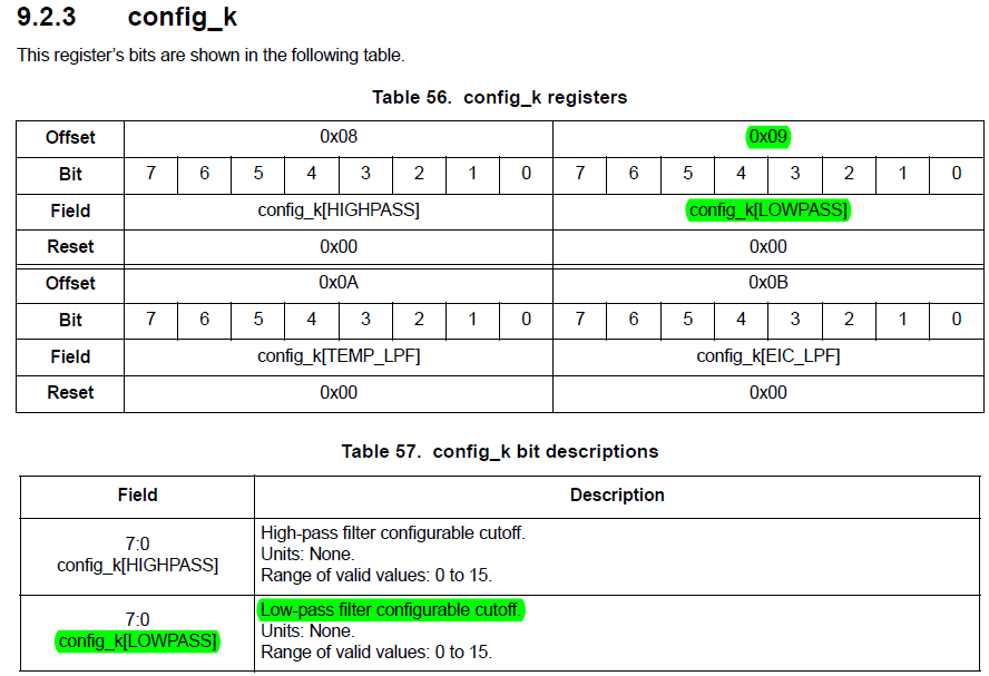

I'm not that surprised that measured acceleration data exhibit some noise, as the LPF coefficient defaults to 0 (no filtering).
Did you tried to configure/increase it to reduce the noise further?
Having said that, as the LPF has an IIR structure, so you may still experience some residual numeric/quantization noise.
Do you have any requirement on this ?

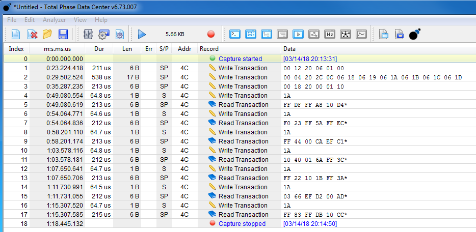

JackITB
Hello Neil,
I configured the MMA9555L with the following settings and it operates as expected (acceleration changes according to DUT orientation).
Please note that default data rate is about 30.5Hz so you need to wait enough time for a new measurement to be completed.
You can also program INT_O output pin as a DataReady interrupt for the host MCU.
W00 12 20 06 01 00 //disable sleep mode (STOPNC) in Sleep-Wake Application
   simplified notation => Write 5 bytes (12 20 06 01 00 hexadecimal), stating at Mailbox/register address 0x00
W00 04 20 2C 0C 06 18 06 19 06 1A 06 1B 06 1C 06 1D //set up quick-read mailboxes MB26-MB31 to contain the FRONTEND_488_100_LPF XYZ data
W00 18 20 00 01 10 //configure the Mailbox application to operate in Legacy mode
R1A-1F (read Mailboxes/registers 0x1A to 0x1F in "Quick-read Legacy mode")
move the DUT
R1A-1F
move the DUT
etc...
Below is the I2C transaction log:
Regards,   Jacques.
