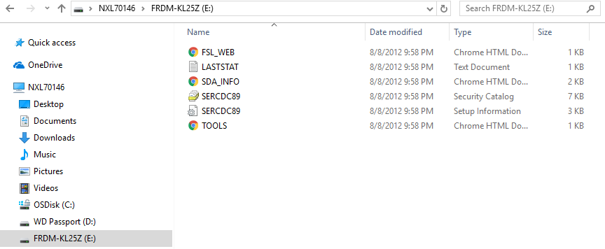

Dear Miyamoto-san,

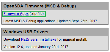

Sounds like your customer is experiencing the issue described in Chapter 7.1 of the STBCEUG. Please recommend him to download and program the board with the latest OpenSDA driver from PEmicro website.

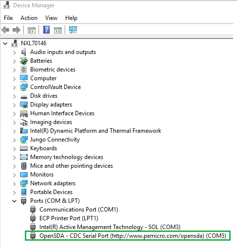

If everything goes well, the FRDM-KL25Z should be detected/shown as a removable disk in Windows Explorer and enumerated as a serial port in the Device Manager/Ports group.
