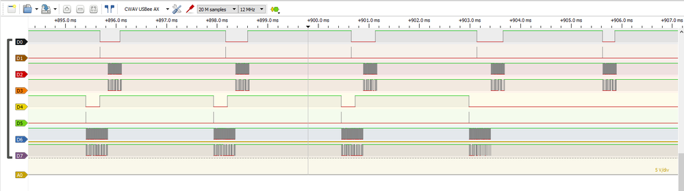

The system works, interrupts are generated, triggers the ISR's and data is read. But after a while, the accelmag sensor fails to deassert the interrupt. Thus never read again.
Here is a scopecap of the failure:
The top 4 (D0 to D3) is the gyro sensor, D0: interrupt D1: PA2, D2: SCL3, D3: SDA3
The bottom 4 (D4 to D7) is the accelmag sensor, D4: interrupt, D5: PA3, D6: SCL3, D7: SDA3
This is just where the accelmag sensor stops responding, near to the end, the interrupt line falls at D4, you see the spike at D5, and I2C data transfer takes place, but the interrupt line is never de-asserted again.
The spikes indicate entering and exiting of the ISR.
My aim is to syncronize the sensors. For making calculations to get orientation from gyro, accelmag with extended kalman filtering, it is of great importance that the dt does not jitter. At first I was reading gyro's data_ready interrupt, and then reading the accelmag sensor, but then I tried a 2 interrupt approach, and It works but only for few minutes, then I get this error. At higher speeds like 400hz it crashes within few seconds.
Any comments on sycnronization of these sensors, and ideas/help on the problem greatly appreciated.
