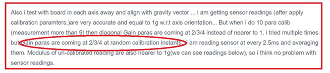

Also i test with board in each axis away and align with gravity vector ... i am getting sensor readings (after apply calibration paramters,)are very accurate and equal to 1g w.r.t axis orientation... But when i do 10 para calib (measurement more than 9) then diagonal Gain paras are coming at 2/3/4 instead of nearer to 1. i tried multiple times but Gain paras are coming at 2/3/4 at random calibration instants.. i am reading sensor at every 2.5ms and averaging them. Modulus of un-calibrated reading are also nearer to 1g(we can see readings below), so i think no problem with sensor readings.

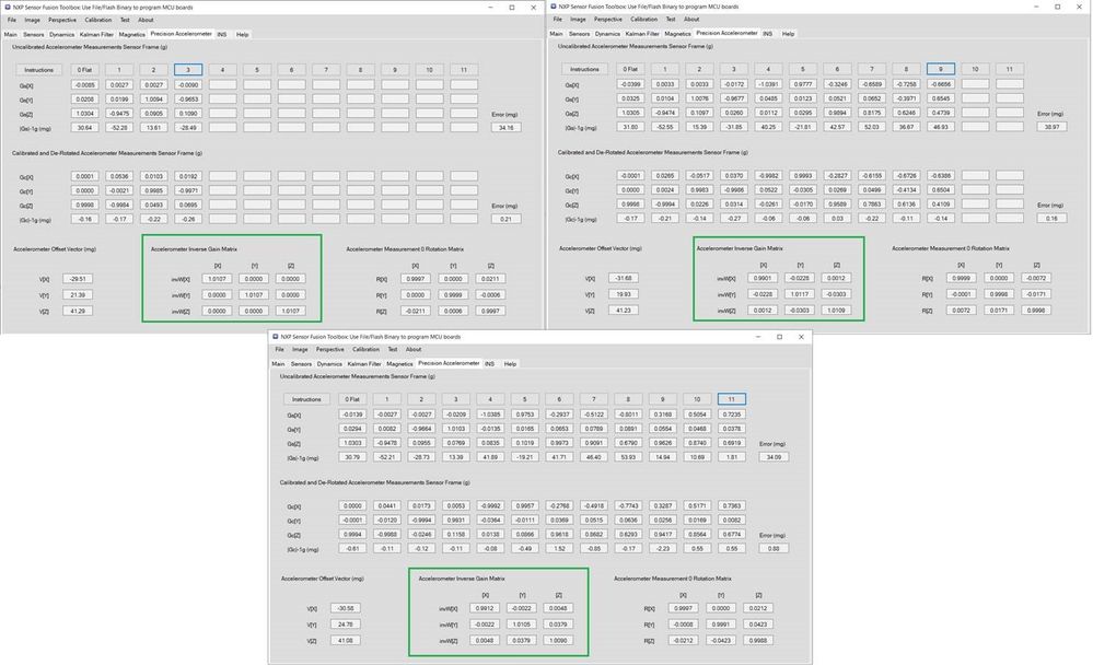

I tried performing 12-point calibration multiple times using FRDM-K64F-AGM01 having FXOS8700 on Sensor Fusion toolbox and not able to create reported scenario (for quick reference providing below snapshot of issue reported):

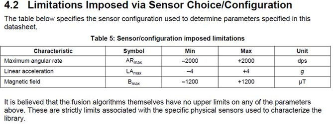

I would recommend checking the sensor register configuration used in your setup. Also see following sensor configuration limit as suggested by sensor fusion design spec document:
Providing you below snapshot of my trials (with 4-point, 10-point, 12-point calibration) at my end (you can see that the acceleration inverse gain matrix diagonal values are always near to ~1).
