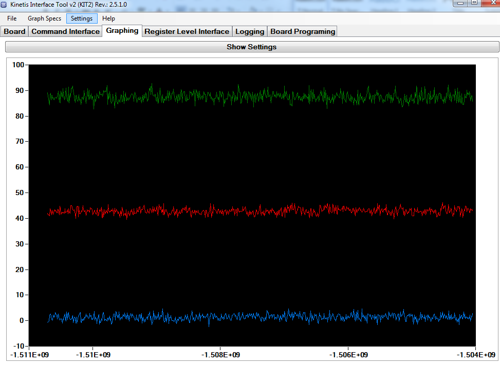

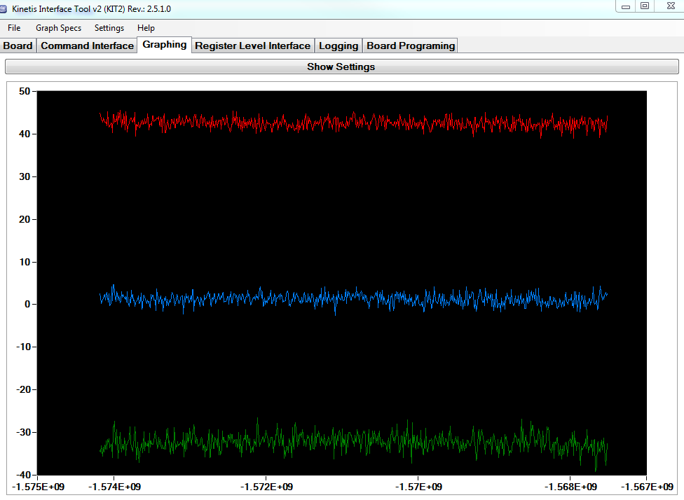

Yes you are right . You can write both positive and negative values in 15 bit two's complement (with <<1). Please find that the Z axis (green) in the graphs below that has exact +60 and -60 uT shifts.
Without Offset (0x43 =00, 0x44 =00)     60uT Z axis offset (Value =0x04B0)  With 60uT Z axis offset (Value =0xFB50)

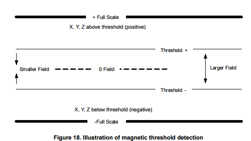

The thresholds are unsigned 15-bit values with 0.1uT/LSB resolution. This means as shown in datasheet (figure 18)
If you set a threshold value as 'X' it means both Threshold '+X'  and threshold '-X' are defined
Now, it seems like in your example you have directly written the value 0xFC18 to THS register. But have you taken care of the right shift operation as bit field position 15 is m_ths_dbcntm? (>>1). You might have ended up with a different offset shift value. pls check with this.

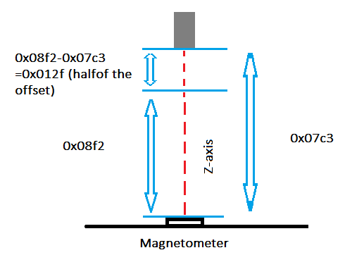

I do my offset calibration,put my magnet in place, take a reading and apply it to ths register. it should be at this point that an interrupt is generated, but my interrupt is generated exactly my ths value-half of my offset value?
This how i do my offset (no magnet in place, takes an average reading and applies it to the offset register after been left shifted). My offset is 0x25e(before left shifting).
I then move my magnet into place, take an average reading and apply this reading to the ths register.
But my interrupt is generated when the reading is greater than 0x07c3 even though my thershold is set to 0x08f2. The difference between 0x08f2 and 0x07c3 is 0x012f, half of my offset value before it has been left shifted one place.
Any idea why this is happening?
