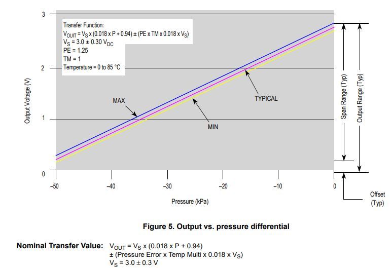

I want to know about the relationship between the pressure value and the output voltage value
我想知道关于压力值与输出的电压值对应的关系
Thank you very much.

Hi Peikai,
This is shown in the datasheet (Figure 5):
