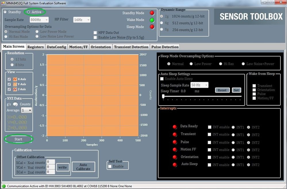

I am using the Freescale MMA8652FC evaluation board. The LED indicators used to show detection events are not working, nor is there any information being displayed in the graphs. Has anyone experienced this before?

Hi Tim,

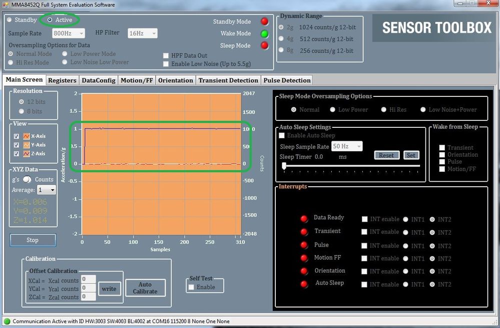

I suppose you are using the Full System Evaluation application as shown below. Did you enable the Active option button to enter the Active mode? Then you can view the collected data in the graph by pressing the Start button:
To use any of the embedded functions (orientation, transient, tap etc.), you need to configure it first in the corresponding tab, then click the “Set” button and enable the Active mode again. For more information, please refer to the MMA845xQ Sensor Toolbox User’s Guide or see Freescale Xtrinsic MMA8451Q Full Evaluation Mode Software Overview (Video Series, 2 of 10) - YouTube.
