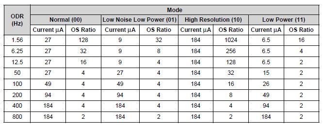

I have a strange power consumption problem with the MMA8652.
When this chip is running, and is in standby state, it consumes 5.2mA.
With the MMA8652 disabled the MCU consumes 2.2mA.
So MCU + MMA8652 running the board consumes 7.4mA.
The MMA8652 functions correctly and reads all angles etc, and this is repeated on more than 3 new build boards.
But I cannot understand why it consumes so much power.  One question I do have is, I have connected both of the interrupt lines interrupt 1 and 2.  I am using interrupt1 and this is active low.  So the MCU pin is setup as in and pull_up.  The second unused interrupt line interrupt2 pin is setup as in and pull_up.  Would this second unused interrupt pin be consuming all the power?
Any ideas or tests would be greatly appreciated.
Look forward to your reply.
Thanks.
Tuurbo46

david_diaz
The Table 101 from the datasheet shows the expected current consumption in regard with the power mode and ODR (Hz) selected.
Could you please give me more details of your application such as ODR and power mode used?

Hi David,
* VCC = 3.3V
* Motion Mode = Transient
* Power Mode = Ctrl_Reg2, 0x01
* ODR = 100Hz
Tuurbo46
