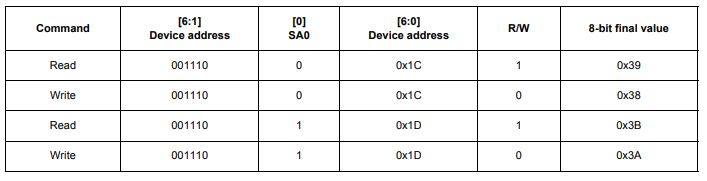

If you have an oscilloscope or a logic analyzer, can you please post here a plot illustrating what is going on the bus when you read the WHO_AM_I register?
Also please make sure you are using correct slave address depending on the connection of the SA0 pin.
Tomas
