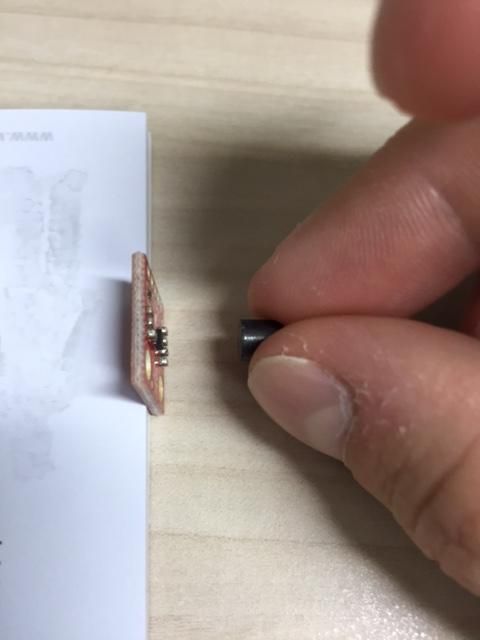

Last question, if you approach a magnet in front of the sensor, for example on the Z axis (see photo below)
The saturation value is +/- 32768 LSB => 3276,8µT => 3,2768mT ?
Is that ok?
Have an excellent day.
Nicolas DECROZE.

Hello Nicolas,
The strength of a typical refrigerator magnet is about 5mT. I assume your output reading is correct.
Based on the example mentioned before, please note that the first time you power on the board, the sensor launches a calibration procedure to correct measured magnetic fields and well estimate the output.
In this case, to calibrate the sensor, I recommend to make a full rotation with the magnet (doesn’t bother the rotation direction).
When the calibration is over and finalized, the red LED is turned off and a green LED appears.
I hope this information will be useful for you.

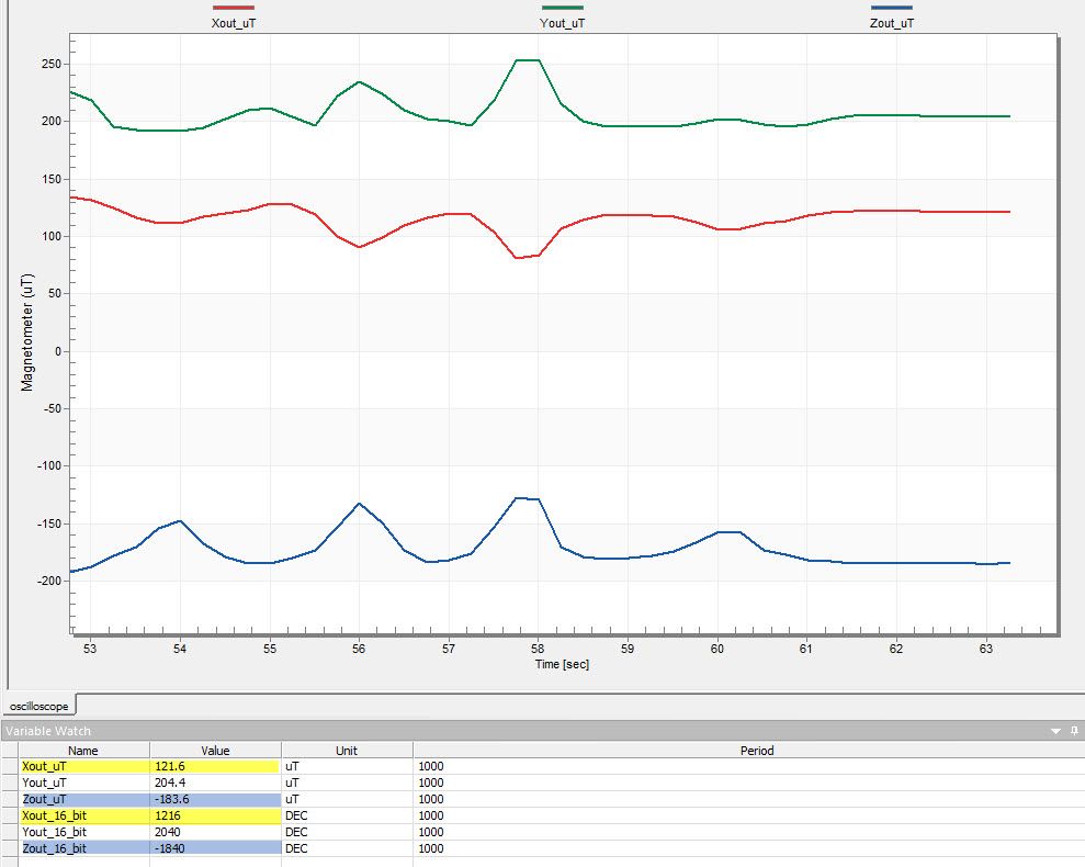

nicolasdecroze
Hello david,
Many thanks it is more clear.
One more question.
In your example, I can't find the link between Xout_16-bit (61552 DECIMAL) and Xout_ut (-671.6 uT). (surrounded in red on the picture below).
If i follow your source code, i found -3984 DECIMAL and -398.4 uT.
Is there a problem in my conversion?
Many thanks for your help.
Nicolas DECROZE
