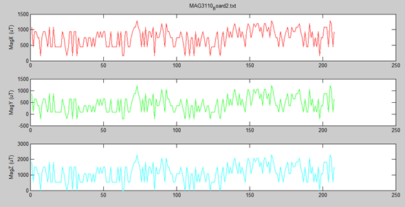

We are using MAG3110 sensor for parking occupancy detection application. We are getting varying results even when the sensor is placed in fixed position and there is no moving objects around the sensor (Please find attached file).
Our configuration is as follows:
CTRL_REG2 = 0x80
CTRL_REG1 = 0x01
I am reading in while loop during interrupt from MAG3110
Please suggest any method to get the stable reading , since our application is to detect a vehicle whenever the vehicle is over the sensor.

Hi Fakhruddin,
You didn't get correclty the magnetic data from the sensor to your raspberry. If you plot your data in a chart, you can see the curve shape is similar on the three axis (not same scale/offset but same tendencies):
So you really need to check how you communicate with the MAG3110  (are you sure to read the right registers?) and how do you convert it. If you need more support, please share your code and the I²C frame screenshots.
I don't think it's a defective part issue there, but if you want a trust supplier for a mag3110 evaluation board, I suggest you to try the BRKT-STBC-AGM01 , you can buy it on NXP website.
Anthony

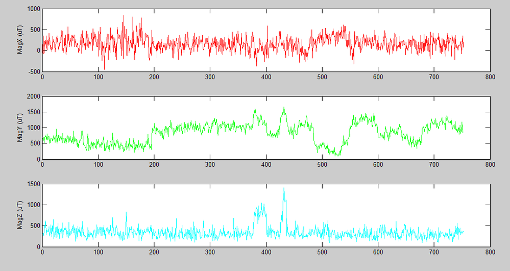

Hi Antony,
We had tried interfacing the 2 MAG3110 boards with both Raspberry Pi-3 board and CC1110
Case 1:- MAG3110 interface with raspberry Pi using I2C protocol
               The code for Raspberry PI-3 board is attached as "mag3110.py"
Case 2:- MAG3110 interface with CC1110 using Bit banging method
               Our main intention to interface the MAG3110 sensor is with the TI's CC1110
               Due to erroneous sensor reading we did some filtering to the raw output of the MAG3110 sensor in the code to get stable reading . The filtered process implemented in the code is as follows:-
1. Exponential average of raw sensor data
2. Difference between the raw and exponential average
3. Squaring the difference
4. Quadratic mean of the Squared Output
The main idea behind the filtering is to detect the drastic change in the earths magnetic field due to presence of the vehicle and make the readings from the sensor raw data with less difference to zero
The code for the CC1110 is attached as "CC1110_MAG3110 code"
Fakhruddin

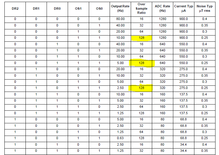

Hi Fakhruddin,
The dataset you provided is very strange, I can't really trust it's comming from our MAG3110 device.
Here my suggestions/questions/feedback/concerns:
Regarding your data:
  • You may have a defective part. Did you test several MAG3110 or only one?
  • Are you sure to well convert the data from the MAG3110 in signed format? The noise scale is unbelivable. I think it is the best track for solution.
Regarding your application:
  • Try to use the raw mode
  • Regarding your application, I'm not sure a 80 Hz datarate well adapted. I may use a lower ODR with a big OSR to reduce the noise comming from the environnement
Let me know if it helps!
