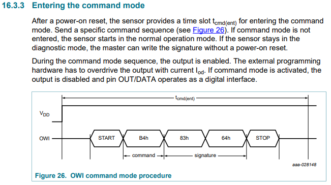

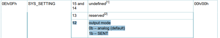

Dear NXP Support Community,
How do I enter the programming mode of KMA310, how do I set the zero angle, and the angle range, how do I switch between analog output and SENT output.

Dear 晨 王,
Please take a closer look at the KMA310 datasheet where you can find answers to some of your questions.
As for the reference software, zero angle/angular range setting I will let wtfan‌ comment on this.
