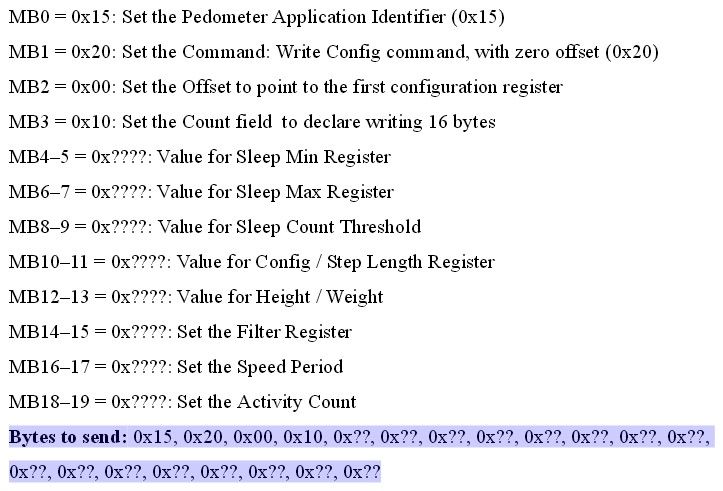

Back to your first question, there is an example project called 'pedometer' at the new SDK drivers for the MCUXpresso IDE. The project is for the FRDM-K64F with MULT2B evaluation board. The example use the FXOS8700 device.
You may download it at:
Welcome to MCUXpresso | MCUXpresso Config Tools
In regard with your last request, once the device is awake, you may proceed with the pedometer application configuration as follow:

Hello David,
you are right, but before doing that I was trying to read the version information of the chipset using the following code, but the response is incorrect. Can you please help. I believe this is the sanity check to ensure that the chip is communicating properly.
Below is the code snippet:
txBuff[0] = 0x00;
txBuff[1] = 0x00;
txBuff[2] = 0x00;
txBuff[3] = 0x0C;
i2c_smbus_write_i2c_block_data(mma9555l_fd, 0X00, 0X04, txBuff)
i2c_smbus_read_i2c_block_data(mma9555l_fd, 0x00, rxBuff)
Response : 0x0 0x0 0x0 0xc 0x0 0x10 0x0 0x10 0x0 0x1 0x0 0x0 0xaf 0x50 0x4 0x3
