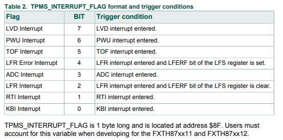

FXTH87,@0x8F address,How do you define each bit of this interrupt?
1 返信
1,686件の閲覧回数
TomasVaverka
Hi Bincheng,
At address 0x8F is located the TPMS_INTERRUPT_FLAG, which is a variable updated in the interrupt vectors, holding information on which interrupts occurred. The bits are described in the Firmware User Guide, below is an extract of the relevant section:
Tomas
