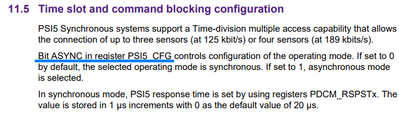

hello,good morning.I wanna config the sensor of FXLS93220 from sync to async . What do i need to do after 31 sync pulse basing on default protocol mode?The tool i used is PSI5-Simulyzer.
Looking forward to your reply!
1 返信
1,567件の閲覧回数
JozefKozon
Dear Shaotian,
please refer to the section 11.5 in an AN12776 attached. To set the FXLS93220 to asynchronous mode, you need to change the ASYNC bit to 1 in the PSI5_CFG register.
