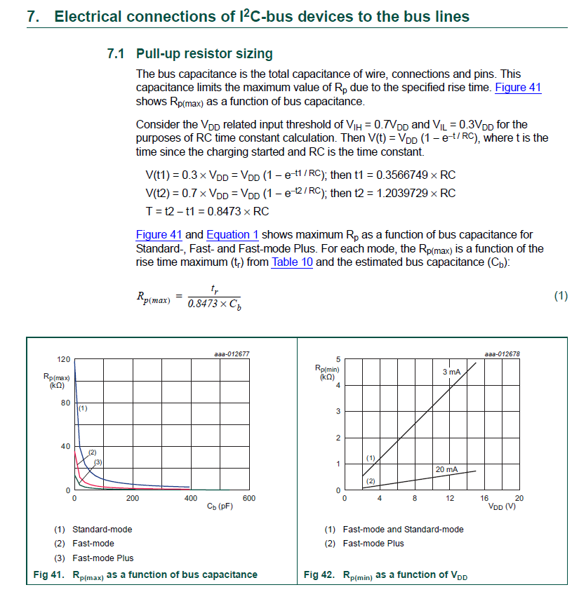

That's totally normal, I²C bus length is limited by the bus capacitance. I²C protocol was not really deployed for long-distance communication. I suggest you to take a look at the I²C-bus specification (I attached a manual about it).
For pull-up resistors, 10K or 4.7K are typical values. Check section 7 of the document for resistor sizing:
But, 12m cable looks a very long distance for I²C... I'm not sure a well pull-resistor sizing will make it works...
Fortunately, it exists I²C bus extender to increase the wire length. We have a large panel of I²C bus extender. You can check at the  I²C Bus Repeaters/Hub/Extenders webpage. For example, the P82B715 can drive IC- signal up to 50meters at 100/400KHz.
