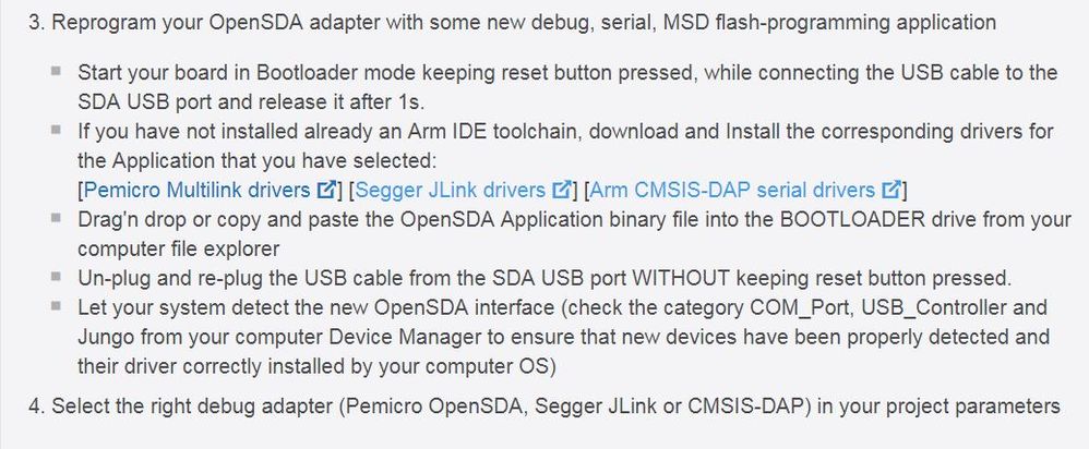

Thanks. I've made some progress. I was using  the ARM CMSIS-DAP serial drivers from Windows serial configuration - Handbook | Mbed
I have downloaded and installed the Segger driver which is specific for FRDM-K64 board (SEGGER - The Embedded Experts - Downloads ) and I have seen a huge improvement. The toolbox sensor and filter outputs don't become erratic anymore after pressing the "record" box. This was done in the laptop running windows 7. But I still see some of the excel lines flying randomly. Which segger openSDA driver are you using?
Have tried in a Windows 10 laptop with similar results.
For all you who need info on how to install SDA drivers for the development boards, visit OpenSDA Serial and Debug Adapter|NXP  and choose your development board. It explains in detail how to enter bootloader mode and links to download the necessary drivers:

j_perezdelarray
The ARM Mbed driver was an executable file that automatically installed drivers once the board had been plugged in. But the truth is that I installed segger drivers with a drag and drop sequence, except you have to enter the bootloader mode of the board by pressing the reset button before plugin it in. I followed the directions of the NXP page above.
Also segger drivers come in a SW package. Once installed you have to look for the USB folder in which drivers can be found.

michaelestanley
That's easy.  Disconnect your K64F from the OpenSDA cable.  Press and hold the reset button while simultaneously reconnecting the cable.  The board will boot in "Bootloader" mode and you will see it as a drive on your computer.  Drag and drop the 02_OpenSDA_FRDM-K64F.bin to that drive.  Once it copies, disconnect and reconnect.  That's it.
