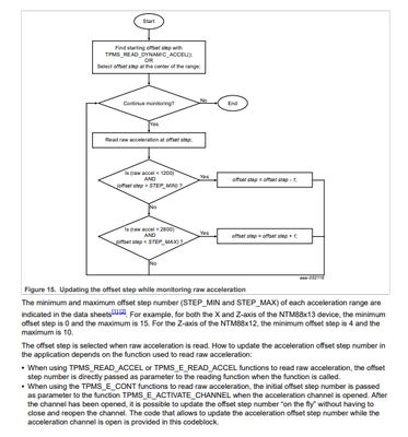

I’m working with the NTM88x12 accelerometer in the extended range option (–175 g to +550 g) and have encountered a few points of confusion. I’ve attached the relevant datasheet table and application-note flowchart for reference.
  1. Implementing AN13614 Offset-Step Identification
    AN13614 shows an algorithm for finding the “starting offset step” and then updating it based on raw ADC readings when using standard ±g ranges. For the –175 g…+550 g option, the NTM88Jxx5S-DS datasheet’s Table 18 indicates that the offset steps are listed in reverse order. When I port the AN13614 logic to this range, should I simply invert the step index comparisons (i.e. decrement where the note increments and vice versa)?

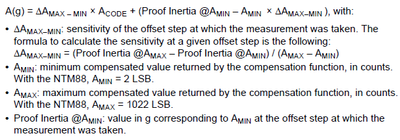

    AN13614 defines the acceleration-transfer function as:
    Can I apply this same formula unchanged for the –175 g…+550 g range—even though its offset steps are in inverted order—or must the formula itself be adjusted to account for the reversal?
[A] Yes, for the extended range (–175 g to +550 g), the offset steps are listed in reverse order in Table 18 of the NTM88Jxx5S-DS datasheet. Therefore, when porting the AN13614 algorithm, you should invert the step index comparisons.
2. Conversion Formula Applicability
[A] The acceleration-transfer function defined in AN13614 can still be applied unchanged, even for the extended range. The formula itself is independent of the offset step order; it operates on the raw ADC values and offset step index.

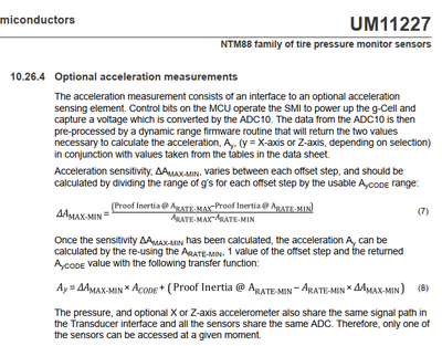

references that include the full set of ΔA (delta), offset, and proof-inertia values for all 16 offset steps across the five acceleration ranges supported by the NTM88 sensor family can be found in the AN13614, UM11227 and in the UM11145. Please see below.
AN13614
  • Formulas for ΔA and Offset:
    • ΔA=2⋅StepSizeLSBmax−LSBminΔA=LSBmaxLSBmin2StepSize
    • Offset=BandMin−(LSBmin⋅ΔA)Offset=BandMin(LSBminΔA)
  • Step-by-step breakdown of how each offset step maps to a subrange of the full acceleration range.
  • Illustrative examples for ranges like –360 g to +400 g, showing how each step overlaps and transitions.
  • Proof-inertia calculation using:
    ΔAMAX–MIN=Proof Inertia @AMAX−Proof Inertia @AMINAMAX−AMINΔAMAX–MIN=AMAXAMINProof Inertia @AMAXProof Inertia @AMIN
UM11145-https://www.nxp.com/docs/en/user-manual/UM11145.pdf
This guide explains how the firmware uses the ΔA and offset values during compensation:
  • Describes the Universal Uncompensated Measurement Array (UUMA) format.
  • Lists all compensation functions, including TPMS_COMP_ACCEL_X and TPMS_COMP_ACCEL_Z.
  • Confirms that compensation relies on factory-programmed trim coefficients, which are essential for accurate results.
For the –175 g to +550 g range, offset steps are listed in reverse order in the datasheet.
https://docs.nxp.com/bundle/UM11227/page/topics/optional_acceleration_measurements.html
