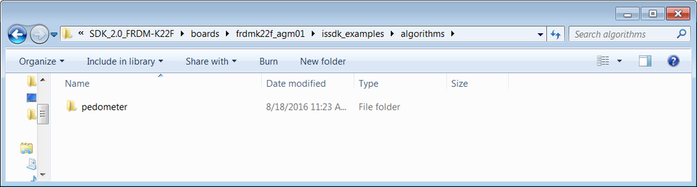

marks
Hi Mike,
I was hoping there would be a bare-metal option as well but did not see one. If I don't select any RTOS then there is no sensorfusion directory created in SDK_2.0_FRDM-K22F\boards\frdmk22f_agm01\issdk_examples\algorithms (only see pedometer). Will there be a bare-metal option? Or am I missing something?
Thanks!
Mark
7,347件の閲覧回数
michaelestanley
Mark,
Check for a new topic in about ten minutes.  I got you covered.
Mike
