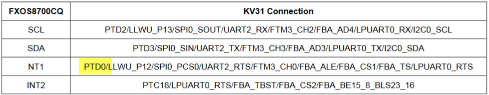

Hello Paulo,
Your configuration seems correct.
Please make sure you have the correct pin configuration using the FRDM-KV31F as mentioned below, especially the INT1 pin:
Please try to decrease the value of the debounce counter (A_FFMT_COUNT = 0x01). Can you share your results? Is the interrupt generated at the PTD0 pin?
David
