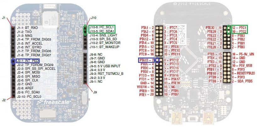

1. As you can see in the FRDM-FXS-MULTI(-B)/FRDM-KL25Z schematics and the image below, I2C signals are routed to the I2C1 module (PTC1 and PTC2 pins) of the KL25Z MCU and the INT1 output (INT_PED) is connected to the PTA13 pin (make sure that pins 2-3 of J5 on the sensor board are connected together using a jumper). The INT1 output of the MPL3115A2 is configured as a push-pull active-low output, so the corresponding PTA13 pin configuration is GPIO with an interrupt on falling edge.
The MCU is, therefore, configured as follows.

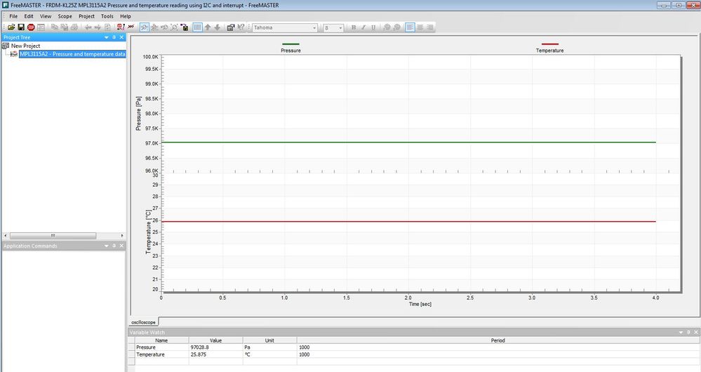

6. The calculated values can be watched in the "Variables" window on the top right of the Debug perspective or in the FreeMASTER application. To open and run the FreeMASTER project, install the FreeMASTER 1.4 application and FreeMASTER Communication Driver.
Attached you can find the complete source code written in the CW for MCU's v10.5 including the FreeMASTER project.
