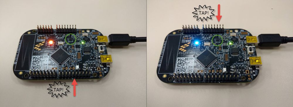

As we know, The MMA8451Q has embedded single/double and directional tap detection.
This post describes an example project using the Single Tap detection for the MMA8451Q included on the FRDM-KL25Z.
Figure 1. Depending on the tapping direction, positive or negative of each axis, the RGB LED will turn into a different color.
For more detailed information on how to configure the device for tap detection please refer to NXP application note, AN4072.

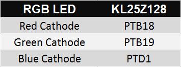

Configure the RBG LED of the FRDM-KL25Z
Based on FRDM-KL25Z User's Manual , the RGB LED signals are connected as follow:
The pins mentioned, are configured as output.
