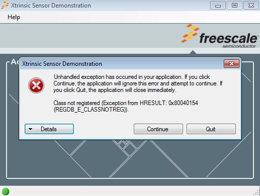

Issue
Using the STB GUI for eCompass kits RD4247MAG3110 and RD4247FXOS8700 only -- v6.1.0.1 on a machine that does not have the Adobe Flash Player ActiveX program installed may run into the following error after pressing the eCompass button:
Solution
Install the Adobe Flash Player + ActiveX from Adobe.
Let us know if you are facing any other issues with the STB GUI v6.1.0.1.
