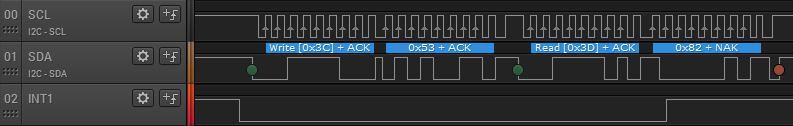

If you are interested in a simple bare metal example code illustrating the use of the magnetic threshold detection function, please find below one of my examples I created for the FXOS8700CQ while working with the NXP FRDM-KL25Z platform and FRDM-FXS-MULT2-B sensor expansion board.
The FXOS8700CQ is set to detect magnetic field exceeding 12.8uT (128 counts) for a minimum period of 100ms on the X-axis. Once an event is triggered, an active low interrupt will be generated on the INT1 pin:
void FXOS8700CQ_Init (void)
   I2C_WriteRegister(FXOS8700CQ_I2C_ADDRESS, M_THS_X_MSB_REG, 0x00); // Threshold value MSB
   I2C_WriteRegister(FXOS8700CQ_I2C_ADDRESS, M_THS_X_LSB_REG, 0x80); // Threshold value LSB
   I2C_WriteRegister(FXOS8700CQ_I2C_ADDRESS, M_THS_CFG_REG, 0xCB);   // Event flag latch enabled, logic OR of enabled axes, only X-axis enabled, threshold interrupt enabled and routed to INT1
   I2C_WriteRegister(FXOS8700CQ_I2C_ADDRESS, M_THS_COUNT_REG, 0x0A); // 100ms at 100Hz ODR and magnetometer mode only
   I2C_WriteRegister(FXOS8700CQ_I2C_ADDRESS, M_CTRL_REG1, 0x1D);     // Max OSR, only magnetometer is active
   I2C_WriteRegister(FXOS8700CQ_I2C_ADDRESS, CTRL_REG3, 0x00);       // Push-pull, active low interrupt
   I2C_WriteRegister(FXOS8700CQ_I2C_ADDRESS, CTRL_REG1, 0x19);       // ODR = 100Hz, Active mode
In the ISR, only the interrupt flag is cleared and the M_THS_SRC (0x53) register is read in order to clear the SRC_M_THS flag in the M_INT_SRC register and deassert the INT1 pin, as shown on the screenshot below.
void PORTD_IRQHandler()
   PORTD_PCR4 |= PORT_PCR_ISF_MASK;  // Clear the interrupt flag
   M_Ths_src=I2C_ReadRegister(FXOS8700CQ_I2C_ADDRESS, M_THS_SRC_REG);   // Read the M_THS_SRC register to clear the SRC_M_THS flag in the M_INT_SRC register and deassert the INT1 pin
   Event_Counter++;
Attached you can find the complete source code. If there are any questions regarding this simple example code, please feel free to ask below.
