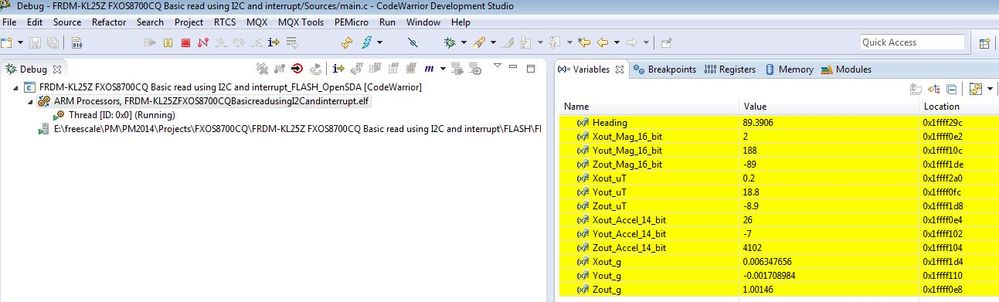

8. Visualization of the calculated values in the FreeMASTER tool.

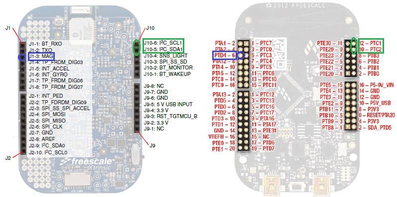

1. As you can see in the FRDM-FXS-MULTI(-B)/FRDM-KL25Z schematics and the image below, I2C signals are routed to the I2C1 module (PTC1 and PTC2 pins) of the KL25Z MCU and the INT1 output is connected to the PTD4 pin (make sure that pins 1-2 of J3 on the sensor expansion board are connected together using a jumper). The INT1 output of the FXOS8700CQ is configured as a push-pull active-low output, so the corresponding PTD4 pin configuration is GPIO with an interrupt on falling edge.
The MCU is, therefore, configured as follows.
void MCU_Init(void)
     //I2C1 module initialization
     SIM_SCGC4 |= SIM_SCGC4_I2C1_MASK;        // Turn on clock to I2C1 module
     SIM_SCGC5 |= SIM_SCGC5_PORTC_MASK;       // Turn on clock to Port C module
     PORTC_PCR1 |= PORT_PCR_MUX(0x2);         // PTC1 pin is I2C1 SCL line
     PORTC_PCR2 |= PORT_PCR_MUX(0x2);         // PTC2 pin is I2C1 SDA line
     I2C1_F  |= I2C_F_ICR(0x14);              // SDA hold time = 2.125us, SCL start hold time = 4.25us, SCL stop hold time = 5.125us
     I2C1_C1 |= I2C_C1_IICEN_MASK;            // Enable I2C0 module
     //Configure the PTD4 pin (connected to the INT1 of the FXOS8700CQ) for falling edge interrupts
     SIM_SCGC5 |= SIM_SCGC5_PORTD_MASK;       // Turn on clock to Port A module
     PORTD_PCR4 |= (0|PORT_PCR_ISF_MASK|      // Clear the interrupt flag
                     PORT_PCR_MUX(0x1)|       // PTD4 is configured as GPIO
                     PORT_PCR_IRQC(0xA));     // PTD4 is configured for falling edge interrupts
         //Enable PORTD interrupt on NVIC
     NVIC_ICPR |= 1 << ((INT_PORTD - 16)%32);
     NVIC_ISER |= 1 << ((INT_PORTD - 16)%32);

7. The output values from accelerometer registers 0x01 – 0x06 are first converted to signed 14-bit integer values and afterwards to real values in g’s. Similarly, the output values from magnetometer registers 0x33 – 0x38 are first converted to signed 16-bit integer values and afterwards to real values in microtesla (µT).

8. The calculated values can be watched in the "Variables" window on the top right of the Debug perspective or in the FreeMASTER application. To open and run the FreeMASTER project, install the FreeMASTER 1.4 application and FreeMASTER Communication Driver.
