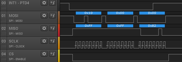

If you are interested in a simple bare metal example code illustrating the use of the FXLS8471Q orientation detection function, please find below one of my examples I created for the FXLS8471Q accelerometer while working with the NXP FRDM-KL25Z platform and FRDMSTBC-A8471 board.
This example code complements the code snippet from the  AN4068.

In the ISR, only the interrupt flag is cleared and the PL_STATUS (0x10) register is read in order to:
- Clear the SRC_LNDPRT flag in the INT_SOURCE register and deassert the INT1 pin, as shown on the screenshot below.
- Get orientation information. 0x82 in this example corresponds to "Portrait down" orientation.
void PORTD_IRQHandler()
  PORTD_PCR4 |= PORT_PCR_ISF_MASK; // Clear the interrupt flag
  PL_Status = FXLS8471Q_ReadRegister(PL_STATUS_REG); // Read the PL_STATUS register to clear the SRC_LNDPRT flag in the INT_SOURCE register
