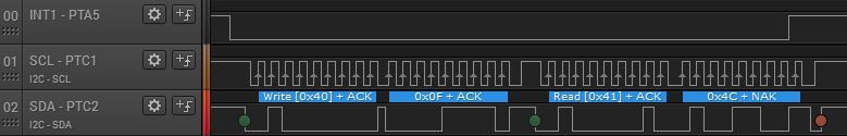

The FXAS21002C is set for detection of an angular rate exceeding 96 dps for a minimum period of 20 ms on either the X or Y axes. Once an event is triggered, an interrupt will be generated on the INT1 pin:

In the ISR, only the interrupt flag is cleared and the RT_SRC register (0x0F) is read in order to clear the EA status bit and deassert the INT1 pin, as shown on the screenshot below. 0x4C in the RT_SRC register indicates that the rate threshold event has been detected on the Y-axis and was negative.
