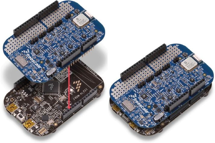

The Freescale Freedom KL26Z hardware (FRDM-KL26Z) is a capable and cost-effective design featuring a Kinetis L series microcontroller, the industry’s first microcontroller built on the ARM® Cortex™-M0+ core. It features a KL26Z128VLH4 (KL26Z), a device boasting a maximum operating frequency of 48MHz, 128KB of flash. The FRDM-KL26Z features the Freescale open standard embedded serial and debug adapter known as OpenSDA. You can find more information at following link: FRDM-KL26Z: Freescale Freedom Development Platform for Kinetis KL16 and KL26 MCUs (up to 128 KB Flas...
The second required board for this example is the Freescale's Freedom Development Platform for Multiple Xtrinsic Sensors, the FRDM-FXS-MULTI. It is a sensor expansion board that contains 7 sensors among which is the FXAS21000 Xtrinsic 3-axis gyroscopic sensors.

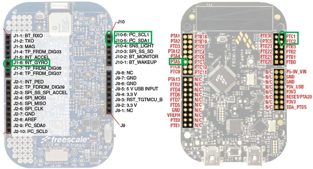

The Gyro embedded registers are accessed through an I2C serial interface and routed to KL26Z I2C 1 module with following pin association.
Precisely the 7-bit I2C slave address is 0x20 (SA0=0) and SCL1, SDA1 lines are routed to port C of the I2C 1 module at KL26Z board pins PTC1 and PTC2:

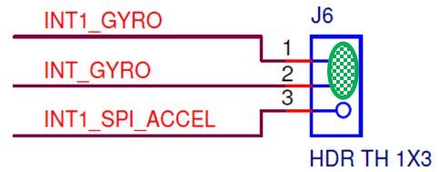

Proper interrupt INT1_GYRO at J1-6 needs to be routed via jumper on J6 to INT_GYRO as shown in following block diagram since the interrupts are shared with other sensors:
This is then handled as GPIO port A: PTA at the KL26Z board and configured for the falling edge interrupts.

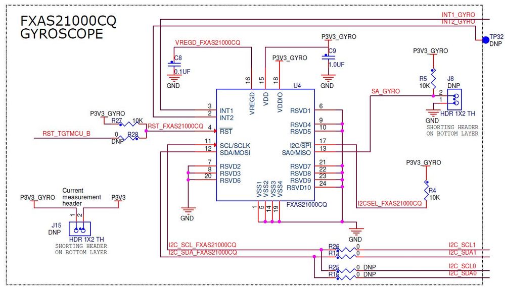

For more details see the schematics of the FRDM-FXS-MULTI block diagram.

1. According to the schematic, the INT1_GYRO output of the FXAS21000 is connected to the PTA5 pin of the KL26Z MCU and both SCL and SDA lines are connected to the I2C1 module (PTC1 and PTC2 pins). The MCU is, therefore, configured as follows:

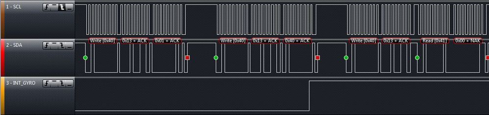

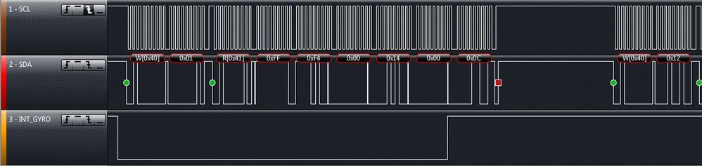

     Below are the snap shots of write and read section of the registers from the instructions above.

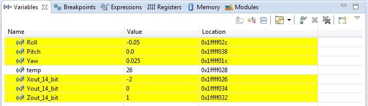

     5. The calculated values can be watched in the "(x)= Variables" window on the top right of the Debug perspective of the CodeWarrior IDE or in the FreeMASTER application.

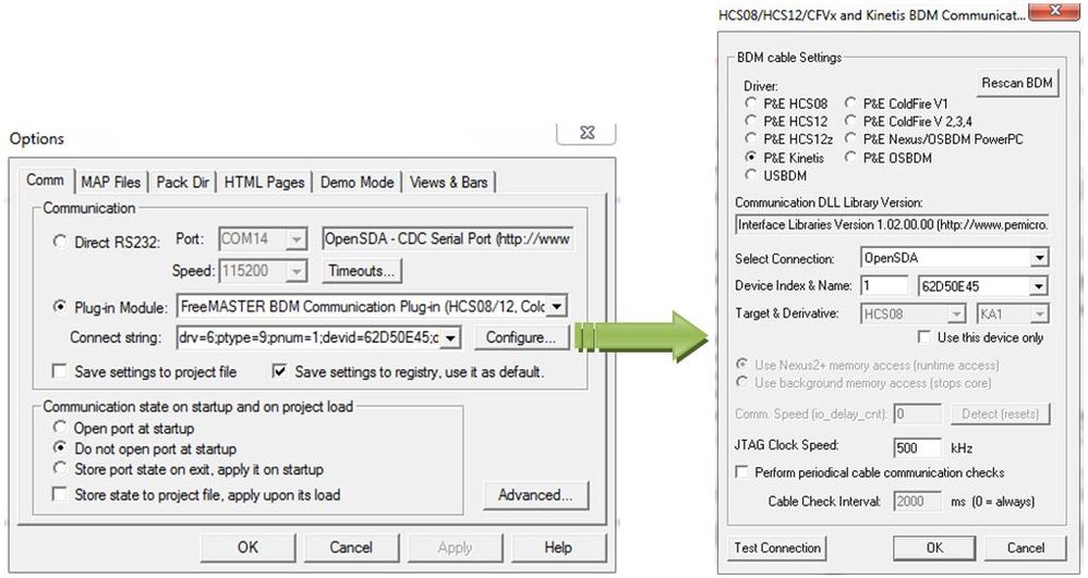

     For board communication in FreeMASTER following Options of Plug-in Module needs to be selected and configured for the BDM P&E Kinetis cable settings:

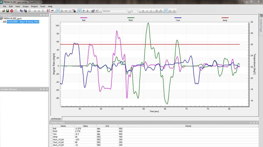

     FreeMASTER in action screenshot:
