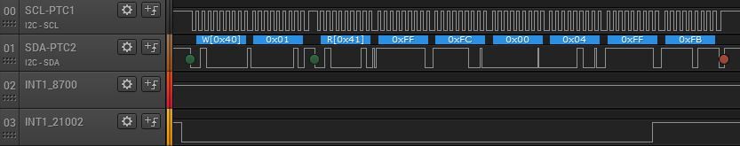

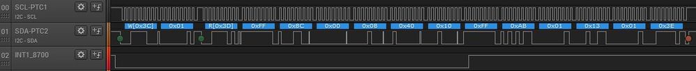

2. The 7-bit I2C slave address of the FXOS8700CQ is 0x1E since both SA0 and SA1 pins are shorted to GND. The address of the FXAS21002C is 0x20 since SA0 pin is also shorted to GND.
The two screenshots below show the write operation which writes the value 0x25 to the CTRL_REG1 (0x2A) of the FXOS8700CQ and 0x16 to the CTRL_REG1 (0x13) of the FXAS21002C.
Here is the single byte read from the WHO_AM_I register. As you can see, it returns the correct value 0xC7 for the FXOS8700CQ and 0xD7 for the FXAS21002C.
Finally, a burst read of 12 bytes from the FXOS8700CQ output data registers (0x01 – 0x06 and 0x33 – 0x38) and 6 bytes from the FXAS21002C output data registers (0x01 – 0x06) is shown below.

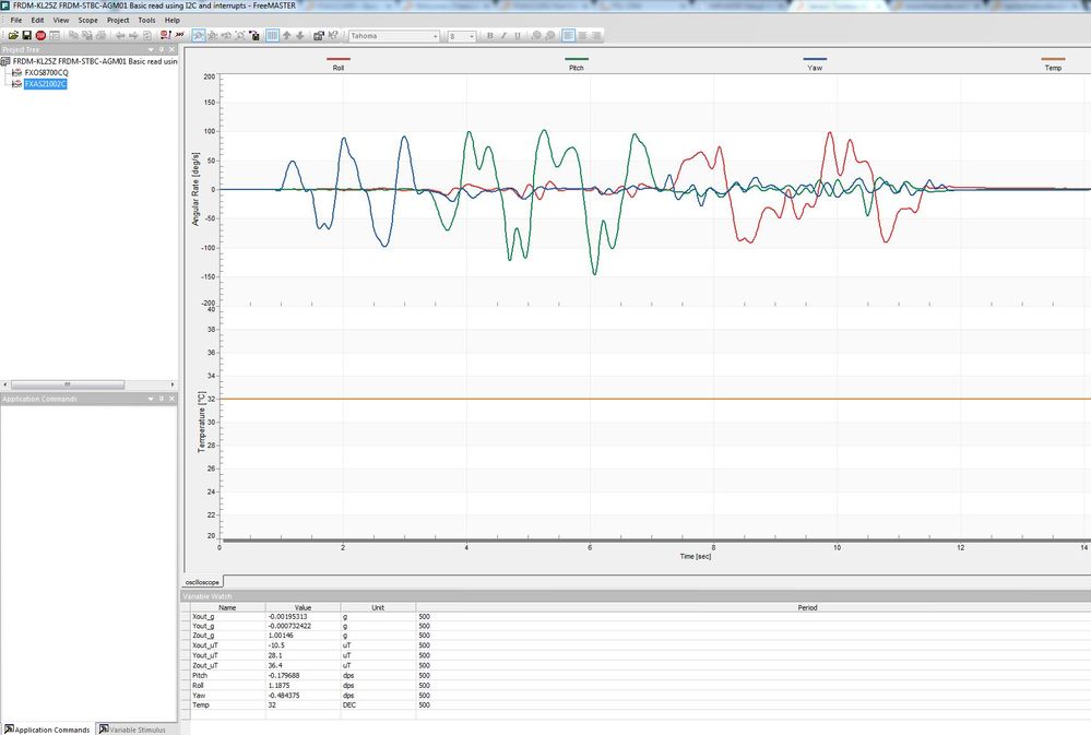

7. The calculated values can be watched in the "Variables" window on the top right of the Debug perspective or in the FreeMASTER application. To open and run the FreeMASTER project, install the FreeMASTER application and FreeMASTER Communication Driver.
I guess this is enough to let you start experimenting with the FRDM-STBC-AGM01 board. Attached you can find the complete source code written in the CW for MCU's v10.6 including the FreeMASTER project.
If there are any questions regarding this simple application, do not hesitate to ask below. Your feedback or suggestions are also welcome.
