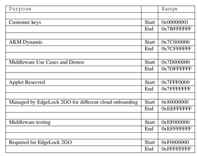

According to AN13030 Plug & Trust MW Documentation (Rev. 1.9 — 30 June 2022), the range of keyid from 1 to 0x7BFFFFFF is opened to users. But users can't delete the keyid from 1 to 3 by using Se05x_API_DeleteAll_Iterative(). I think the implementation of the Se05x_API_DeleteAll_Iterative() does not allow it.
3.14 Key Id Range and Purpose

Yes, the range of keyid from 1 to 0x7BFFFFFF is opened to users, but there are cases customers trust provision some secure objects there, and SE05X_OBJID_TP_MASK can be used to prevent deleting such kind of objects accidently , but of course users may adjust SE05X_OBJID_TP_MASK definition according to their requirements.

I suspected there is a policy to protect NXP's special trust provisioning objects. Additionally, I considered the middle ware should implement the restriction for all apis. But, sure, if middle ware restrict to delete the keyid in all apis, users may not handle under unexpected situation.
Anyway since you mentioned users can adjust the protection, I will modify the range of the macro to my suitable spec.
