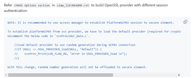

Hi @eal-fox ,
To use provider with SCP03 , you have to add the following code manually at first.
Please kindly refer to https://github.com/NXPPlugNTrust/se05x-openssl-provider for more details.
Please also be aware that the github version has some new features beyond the current MW and will be merged into the next release, so for now, please use the github version provider instead.
Kan
