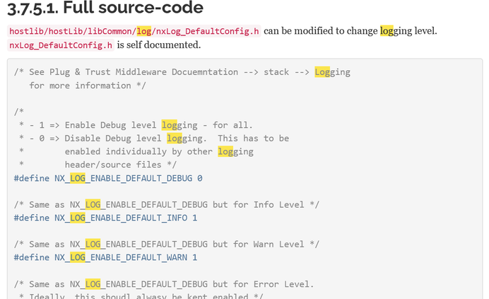

Kan_Li
Hi @fvjdxe ,
Thanks for the information! While it is not what I am looking for. You have to use nxLog_DefaultConfig.h to enable the debug logging globally. Please refer to the following for details.
Looks like your application is based on MW, would you please specify the version? and there is a demo code for your reference, which is available in "SE-PLUG-TRUST-MW\simw-top\demos\se05x\se05x_Delete_and_test_provision\se05x_Delete_and_test_provision.c"
and you may also share some code snippet like this for further analyze.

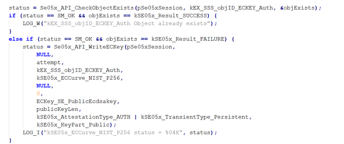

fvjdxe
Hello Kan,
I am using version 3.0.3 of the middleware. Please find a log attached as se050-provision-eckey.log.
My code is pretty close to the example:
int r = Se05x_API_WriteECKey(& session_ctx
    NULL,
    SE05x_MaxAttemps_UNLIMITED,
    0x00000100UL,
    kSE05x_ECCurve_NIST_P256,
    nullptr,
    0,
    gPublicKey,
    sizeof(gPublicKey),
    kSE05x_AttestationType_AUTH | kSE05x_TransientType_Persistent,
    kSE05x_KeyPart_Public);
9,722 Views
Kan_Li
Hi @fvjdxe ,
Thanks for the information! The code snip looks good. We just tried your code and it was able to create a EC Key Object using the same APDU. so we are wondering if you are able to create any other object. Did you run any other examples using this device? Please kindly clarify.
Thanks for your patience!
Kan
