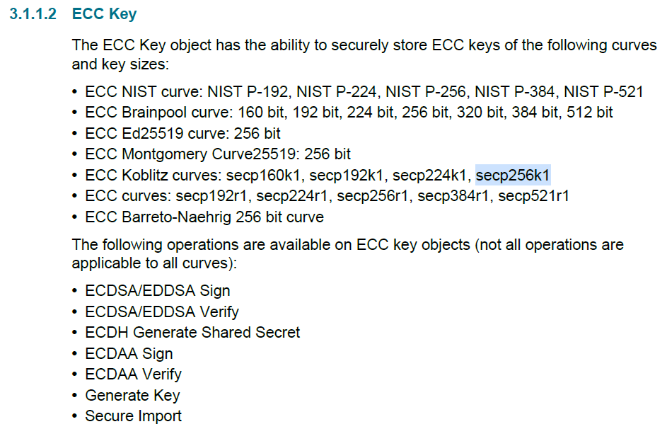

I'm able to create an EC Key pair using a different EC Curve (example: NIST_P256) I'm able to generate it successfully. Is there a limitation in SE050 that doesn't allow to generate key pairs using Koblitz curve ?
The datasheet says the Generate Key operation is available for the mentioned curves but also says that "not all operations are applicable to all curves". Are they talking about the Applicable access rules in Default Policies ?

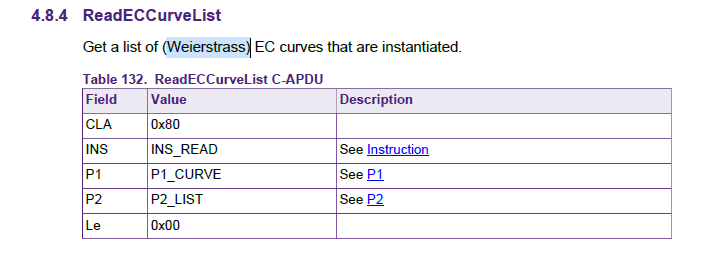

Basically it should work, but I am not sure if you delete this curve from your device, have you tried with the following command to check it?
