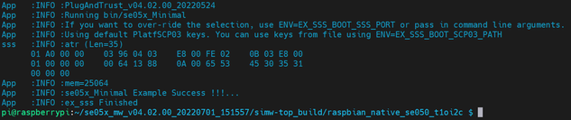

Thanks for the information! Actually I run this demo on Raspberry Pi platform just now, but no issue found.
App :INFO :PlugAndTrust_v04.02.00_20220524
App :INFO :Running bin/se05x_Minimal
App :INFO :If you want to over-ride the selection, use ENV=EX_SSS_BOOT_SSS_PORT or pass in command line arguments.
App :INFO :Using default PlatfSCP03 keys. You can use keys from file using ENV=EX_SSS_BOOT_SCP03_PATH
sss :INFO :atr (Len=35)
00 A0 00 00 03 96 04 03 E8 00 FE 02 0B 03 E8 08
01 00 00 00 00 64 00 00 0A 4A 43 4F 50 34 20 41
54 50 4F
App :INFO :mem=32767
App :WARN :If 32768 bytes or more bytes are available, 32767 bytes free is reported.
App :INFO :se05x_Minimal Example Success !!!...
App :INFO :ex_sss Finished
pi@raspberrypi:~/se05x_mw_v04.02.00_20220701_151557/
The only difference is I set PTMW_SE05X_Ver = 03_XX as I am using OM-SE050ARD, would you please tell me the OEF ID you got from the GetInfo demo? The value is something like below:

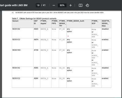

ajitsj3
From the document https://www.nxp.com/docs/en/application-note/AN13027.pdf  I figured out that for OEFID value "A564" the se05x variant is "SE051C2" and we need to use the PTMW_SE05x_Ver=06_00 which is what even we have used. I have attached screenshot of the table for your reference. So please use the variant "SE051C2" at your and perform same tests.
I also could not find scp_keys for "SE051C2" variant. Please could you provide the same?

Thanks for the information! This is an expected result with SE051C2, as it has two OEF ids as shown in https://www.nxp.com/webapp/Download?colCode=AN12973 ,  so you have to manually confirm which default platform SCP03 keys should be used according to the OEF ID you get from the GetInfo demo. Please open the fsl_sss_ftr.h.in file which is located in: /simw-top/sss/inc. and enable the option for "A564" as below:
Then reconfigure the MW with cmake to generate a new "fsl_sss_ftr.h" in place and build it as well. You may have a result something like below:
