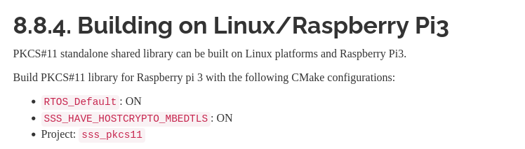

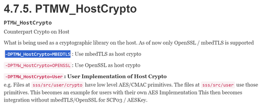

Kan_Li
Hi @msalvinik ,
I think we should use "-DPTMW_HostCrypto=MBEDTLS" instead of "-DSSS_HAVE_HOSTCRYPTO_MBEDTLS=ON" for MW ver 4.5.0. Please kindly refer to the following for details.
Please kindly let me know if the problem is still there.
Kan
8,110 Views
msalvinik
Hi @Kan_Li ,
thank you for your answer.
Unfortunately I have the same problem also building with "-DPTMW_HostCrypto=MBEDTLS" instead of "-DSSS_HAVE_HOSTCRYPTO_MBEDTLS=ON"
By the way, I would suggest to fix the section "8.8.4. Building on Linux/Raspberry Pi3" of the documentation, where is stated that the flag to use is "SSS_HAVE_HOSTCRYPTO_MBEDTLS=ON" (I taken this flag from there)
Screenshot from 2024-02-22 14-36-29.pngScreenshot from 2024-02-22 14-36-29.png

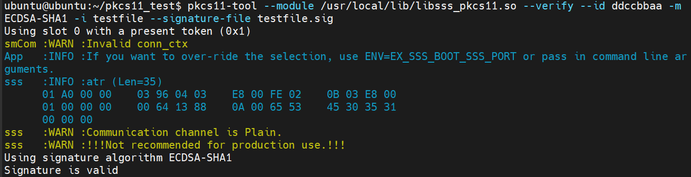

Kan_Li
Hi @msalvinik ,
As a quick solution, please use "--id" instead of "--label" . Please kindly refer to the following for more details.
In this case, the unique identifier of the secure object is 0xaabbccdd and the related ID in pkcs11 is ddccbbaa.
Hope that helps,
Kan
8,036 Views
msalvinik
Hi @Kan_Li ,
thank you for your feedback.
I confirm that your workaround works: with --id (and the reversed key ID) I'm able to select the right key when there are more than one key stored on SE050.

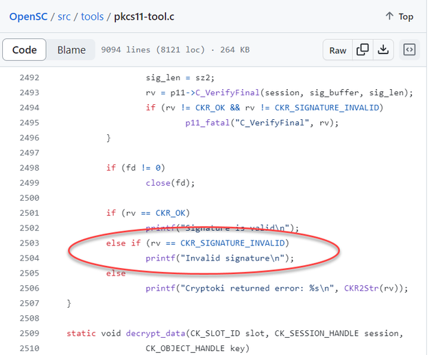

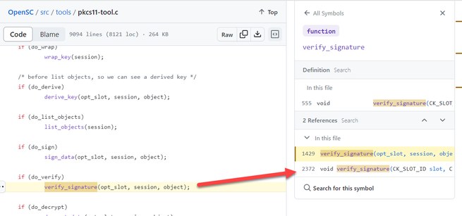

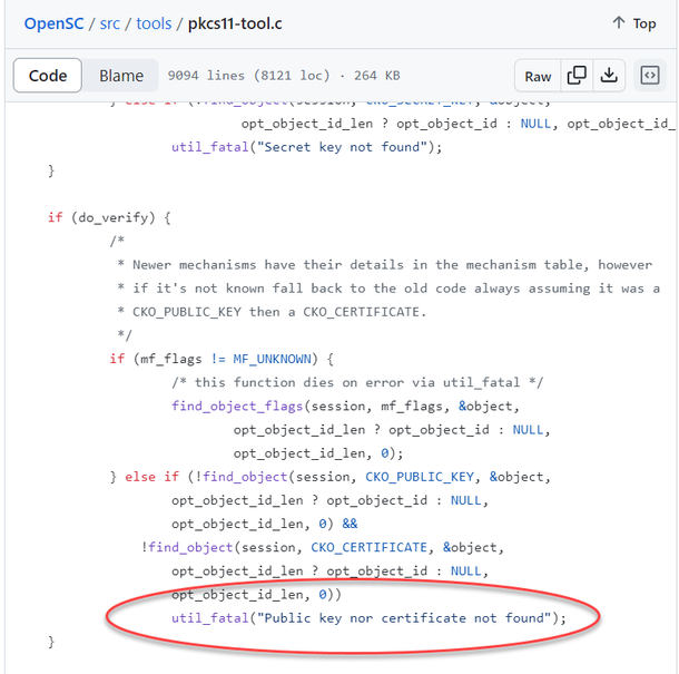

I would like to report another issue: on some conditions, when the signature verification fails the pkcs11-tool returns 0 instead of an error code.
In detail, it happens for example when I pass an invalid signature to check: the verification process fails with log
PKCS11:ERROR: sss_asymmetric_verify_digest Failed...
Invalid signature
but pkcs11-tool returns 0.
Instead, if I use an invalid key ID, the verification process fails with log
error: Public key nor certificate not found
Aborting.
and pkcs11-tool returns 1 (error code).
Don't know if the bug is in libsss_pkcs11.so or in pkcs11-tool.
Thanks in advance, regards
7,986 Views
Kan_Li
Hi @msalvinik ,
It is a pkcs11-tool behavior as shown below:
When using an invalid Key ID , the pkcs11-tool will return 1 by calling util_fatal().
While doing the verify , the API always returns void even when the operation fails.
Only an error message printed in such cases.
Hope that makes sense,
Kan
