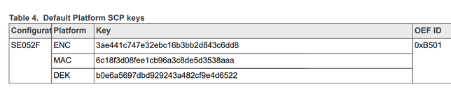

Kan_Li
Hi @daisuke2 ,
The following is the default platformSCP keys for SE052F, was it the same as yours? please kindly refer to https://www.nxp.com/docs/en/application-note/AN14277.pdf for more details.
Applet version mismatch info like  "sss :INFO :Compiled for 0x70200. Got newer 0x70216" doesn't matter at all.
Kan
