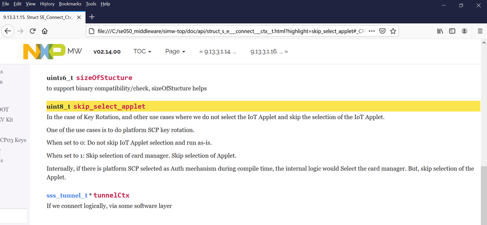

I have trouble with the key rotation demo se05x_TP_PlatformSCP03keys.c.
Let me give you an update to what I did:
Compilation on Linux using build options SE05X_Auth := PlatfSCP03, SCP := SCP03_SSS. Demos se05x_Get_Info and se05x_minimal work well in SCP03 mode. The GP Initialize Update Command succeeds there.
Within se05x_TP_PlatformSCP03keys I left "#define EX_SSS_BOOT_SKIP_SELECT_APPLET 1" in, I just added debug output to verify I used the same old preprovisioned keys that work on other demos successfully.

Further down I add two more detailed logs of both se05x_RotatePlatformSCP03Keys and se05x_minimal.
Apparently nxScp03_GP_InitializeUpdate is called when the demo starts. But in difference to the earlier mentioned other demos, I get error message 6A 88, which means according to GP spec: "Referenced data not found".
The function "tp_PlatformKeys" of the Rotate Demo is not even called, the error comes before that (ex_sss_entry is after the error).
I understand from other discussion that the boot sequence has to be different when rotating keys, can you confirm that? What is the intended "to be"-effect of EX_SSS_BOOT_SKIP_SELECT_APPLET=1? It would help to know which APDU commands SHOULD be applied for rotating keys.
- Different options than: SE05X_Auth := PlatfSCP03 / SCP := SCP03_SSS ?
- Does the SE050´s Global Platform part require specific keys, different from the provisioned ones for SE050C1 (that work on other demos)?

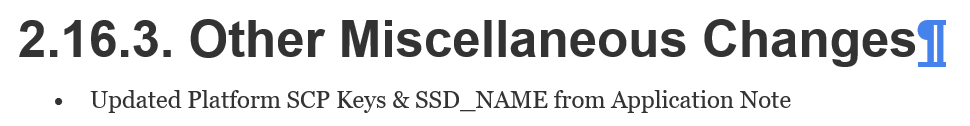

Kan_Li
Hello @mfr64 ,
The  MW version is too old (02.12.00 as shown in the logs), and on this old version the rotate code selects the ISD instead of the SSD. This bug got fixed since 02.12.01, please try with the latest version. You may refer to the following for more details.
Kan

Hello @mfr64 ,
The demo uses the default Platform SCP keys, and EX_SSS_BOOT_SKIP_SELECT_APPLET is used to skip the APDU command for selecting applet, please kindly refer to the following for more details.
Kan

Kan_Li
Hello @mfr64 ,
Kan

mfr64
Hi Kan Li,
I had an copy of v02.12.04, newer than v02.12.00 and it should contain the bug fix as well. Now as I know this version is worth a chance to retry, I did that today with success.
The Key rotation demo works for me, based on v02.12.04 which did not need too much rework to get my code migrated from v02.12.00.
Many thanks!
