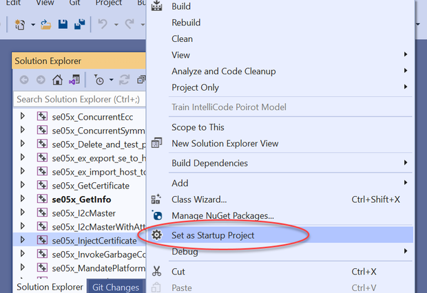

Are you debugging the MW based on Microsoft Visual Studio ? If yes, why not directly run the project of  "se05x_InjectCertificate"? You just have to set up this project as a startup project like below:
Hope that makes sense,
Kan

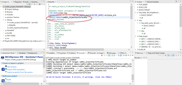

No, I am using McuXpresso
I am sending apdu without applet sessions(EC key session/Aes key sessions). Is that a reason for this error.
3,172 Views
Kan_Li
Hi @nidhintomy ,
No, maybe you didn't import the project correctly. Actually this project is cmake based, so if you are using MCUxpresso, please kindly follow the steps mentioned in https://www.nxp.com.cn/docs/en/application-note/AN12396.pdf , especially chapter 5 - "5 Import project examples from CMake-based build system" , and change the building target to this project after import.
Kan

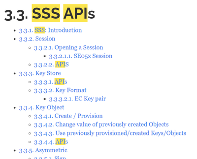

Hi @nidhintomy ,
These are SSS APIs, and there are demos based on SSS APIs, please kindly refer to "simw-top/doc/sss/ex/doc/sss-api-examples.html" for details. For SSS API user guide, you may refer to "simw-top/doc/sss-apis.html".
Hope that helps,
Kan
