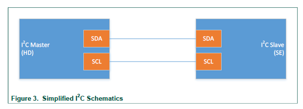

Hello NXP-Community,
I am using at the moment the development Board OM2NTA5332 (NTAG5 Boost) + the OM-SE050ARD (SE050) in which the NTAG5 Boost is the I2C Master and the SE050 is the I2C Slave (default slave address 0x48).
I want to send the APDU Commands via NTAG5 Boost (NFC) to the SE050 and read the Response out of the SRAM.
Any specific drivers needed for the SE050 to communicate between these boards correctly - for the SE050 I am using the "a7x_vcom-T1oI2C-frdmk64f-SE050x.bin" at the moment which is probably the wrong one.
Which driver would be compatible to the NTAG5 Boost?
best regards
Julian

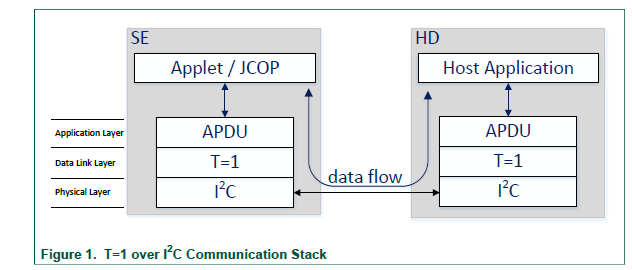

Hi Julian,
Thanks for the clarification! If so, there is no specific driver needed for either OM2NTA5332 (NTAG5 Boost) or OM-SE050ARD (SE050) , you may just connect them as below:
and send APDU commands in T=1 format over I2C as below(This is usually be implemented on the NFC reader side, for example , a NFC phone):
Please kindly refer to the following links for more details.
https://www.nxp.com/docs/en/application-note/AN12368.pdf
https://www.nxp.com/docs/en/reference-manual/RM00221.pdf
https://www.nxp.com/docs/en/user-guide/UM11225.pdf
