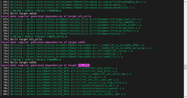

I am getting the below mentioned error while doing cmake build in yocto for PKCS11 configuration.
| cc1: error: -Wformat-security ignored without -Wformat [-Werror=format-security]
| cc1: some warnings being treated as errors
I have pasted the log with the source code files as mentioned below.
| [128/340] ~/work/build/tmp/work/armv7ahf-neon-poky-linux-gnueabi/se05x-pkcs11/04.02.00-r0/recipe-sysroot-native/usr/bin/arm-poky-linux-gnueabi/arm-poky-linux-gnueabi-gcc -DFTR_FILE_SYSTEM -DMBEDTLS_USER_CONFIG_FILE=\"sss_x86_mbedtls_config.h\" -DSSS_USE_FTR_FILE -DT1oI2C -Dmbedtls_EXPORTS -DmqttconfigENABLE_METRICS=0 -I~/work/build/tmp/work/armv7ahf-neon-poky-linux-gnueabi/se05x-pkcs11/04.02.00-r0/simw-top/sss/port/default -I. -I~/work/build/tmp/work/armv7ahf-neon-poky-linux-gnueabi/se05x-pkcs11/04.02.00-r0/simw-top/ext/mbedtls/include -I~/work/build/tmp/work/armv7ahf-neon-poky-linux-gnueabi/se05x-pkcs11/04.02.00-r0/simw-top/ext/mbedtls/library -I~/work/build/tmp/work/armv7ahf-neon-poky-linux-gnueabi/se05x-pkcs11/04.02.00-r0/simw-top/sss/plugin/mbedtls -I~/work/build/tmp/work/armv7ahf-neon-poky-linux-gnueabi/se05x-pkcs11/04.02.00-r0/simw-top/sss/inc -I~/work/build/tmp/work/armv7ahf-neon-poky-linux-gnueabi/se05x-pkcs11/04.02.00-r0/simw-top/hostlib/hostLib/libCommon/infra -I~/work/build/tmp/work/armv7ahf-neon-poky-linux-gnueabi/se05x-pkcs11/04.02.00-r0/simw-top/hostlib/hostLib/inc -I~/work/build/tmp/work/armv7ahf-neon-poky-linux-gnueabi/se05x-pkcs11/04.02.00-r0/simw-top/ext/mbedtls/port/ksdk -I~/work/build/tmp/work/armv7ahf-neon-poky-linux-gnueabi/se05x-pkcs11/04.02.00-r0/simw-top/hostlib/hostLib/libCommon/log/. -I~/work/build/tmp/work/armv7ahf-neon-poky-linux-gnueabi/se05x-pkcs11/04.02.00-r0/simw-top/hostlib/hostLib/libCommon/log/../../platform/inc -I~/work/build/tmp/work/armv7ahf-neon-poky-linux-gnueabi/se05x-pkcs11/04.02.00-r0/simw-top/hostlib/hostLib/libCommon/log/../infra -march=armv7-a -mfpu=neon -mfloat-abi=hard -fstack-protector-strong -D_FORTIFY_SOURCE=2 -Wformat -Wformat-security -Werror=format-security --sysroot=~/work/build/tmp/work/armv7ahf-neon-poky-linux-gnueabi/se05x-pkcs11/04.02.00-r0/recipe-sysroot -O2 -pipe -g -feliminate-unused-debug-types -fmacro-prefix-map=~/work/build/tmp/work/armv7ahf-neon-poky-linux-gnueabi/se05x-pkcs11/04.02.00-r0=/usr/src/debug/se05x-pkcs11/04.02.00-r0 -fdebug-prefix-map=~/work/build/tmp/work/armv7ahf-neon-poky-linux-gnueabi/se05x-pkcs11/04.02.00-r0=/usr/src/debug/se05x-pkcs11/04.02.00-r0 -fdebug-prefix-map=~/work/build/tmp/work/armv7ahf-neon-poky-linux-gnueabi/se05x-pkcs11/04.02.00-r0/recipe-sysroot= -fdebug-prefix-map=~/work/build/tmp/work/armv7ahf-neon-poky-linux-gnueabi/se05x-pkcs11/04.02.00-r0/recipe-sysroot-native= -march=armv7-a -mfpu=neon -mfloat-abi=hard -fstack-protector-strong -D_FORTIFY_SOURCE=2 -Wformat -Wformat-security -Werror=format-security --sysroot=~/work/build/tmp/work/armv7ahf-neon-poky-linux-gnueabi/se05x-pkcs11/04.02.00-r0/recipe-sysroot -Wno-unused-result -fPIC -fPIC -DNDEBUG -fPIC -Wno-unused-function -Wno-error=pointer-sign -Wno-error=format -Wno-format -Wno-implicit-function-declaration -Wno-error=unused-const-variable -Wno-unused-const-variable -MD -MT ext/CMakeFiles/mbedtls.dir/mbedtls/library/ssl_tls.c.o -MF ext/CMakeFiles/mbedtls.dir/mbedtls/library/ssl_tls.c.o.d -o ext/CMakeFiles/mbedtls.dir/mbedtls/library/ssl_tls.c.o -c ~/work/build/tmp/work/armv7ahf-neon-poky-linux-gnueabi/se05x-pkcs11/04.02.00-r0/simw-top/ext/mbedtls/library/ssl_tls.c
| FAILED: ext/CMakeFiles/mbedtls.dir/mbedtls/library/ssl_tls.c.o
| [129/340] ~/work/build/tmp/work/armv7ahf-neon-poky-linux-gnueabi/se05x-pkcs11/04.02.00-r0/recipe-sysroot-native/usr/bin/arm-poky-linux-gnueabi/arm-poky-linux-gnueabi-gcc -DFTR_FILE_SYSTEM -DMBEDTLS -DMBEDTLS_USER_CONFIG_FILE=\"sss_x86_mbedtls_config.h\" -DPLATFORM_IMX -DSSS_USE_FTR_FILE -DT1oI2C -DmqttconfigENABLE_METRICS=0 -Dse05x_EXPORTS -I~/work/build/tmp/work/armv7ahf-neon-poky-linux-gnueabi/se05x-pkcs11/04.02.00-r0/simw-top/sss/port/default -I. -I~/work/build/tmp/work/armv7ahf-neon-poky-linux-gnueabi/se05x-pkcs11/04.02.00-r0/simw-top/hostlib/hostLib/se05x/../se05x_03_xx_xx -I~/work/build/tmp/work/armv7ahf-neon-poky-linux-gnueabi/se05x-pkcs11/04.02.00-r0/simw-top/sss/ex/inc -I~/work/build/tmp/work/armv7ahf-neon-poky-linux-gnueabi/se05x-pkcs11/04.02.00-r0/simw-top/sss/inc -I~/work/build/tmp/work/armv7ahf-neon-poky-linux-gnueabi/se05x-pkcs11/04.02.00-r0/simw-top/hostlib/hostLib/se05x/../libCommon/nxScp -I~/work/build/tmp/work/armv7ahf-neon-poky-linux-gnueabi/se05x-pkcs11/04.02.00-r0/simw-top/sss/port/x86 -I~/work/build/tmp/work/armv7ahf-neon-poky-linux-gnueabi/se05x-pkcs11/04.02.00-r0/simw-top/hostlib/hostLib/libCommon/smCom -I~/work/build/tmp/work/armv7ahf-neon-poky-linux-gnueabi/se05x-pkcs11/04.02.00-r0/simw-top/hostlib/hostLib/libCommon/infra -I~/work/build/tmp/work/armv7ahf-neon-poky-linux-gnueabi/se05x-pkcs11/04.02.00-r0/simw-top/hostlib/hostLib/libCommon/../inc -I~/work/build/tmp/work/armv7ahf-neon-poky-linux-gnueabi/se05x-pkcs11/04.02.00-r0/simw-top/hostlib/hostLib/libCommon/../platform/inc -I~/work/build/tmp/work/armv7ahf-neon-poky-linux-gnueabi/se05x-pkcs11/04.02.00-r0/simw-top/hostlib/hostLib/libCommon/../tstUtil -I~/work/build/tmp/work/armv7ahf-neon-poky-linux-gnueabi/se05x-pkcs11/04.02.00-r0/simw-top/hostlib/hostLib/libCommon/../accessManager/inc -I~/work/build/tmp/work/armv7ahf-neon-poky-linux-gnueabi/se05x-pkcs11/04.02.00-r0/simw-top/hostlib/hostLib/libCommon/log -I~/work/build/tmp/work/armv7ahf-neon-poky-linux-gnueabi/se05x-pkcs11/04.02.00-r0/simw-top/hostlib/hostLib/libCommon/smCom/T1oI2C -I~/work/build/tmp/work/armv7ahf-neon-poky-linux-gnueabi/se05x-pkcs11/04.02.00-r0/simw-top/hostlib/hostLib/libCommon/log/. -I~/work/build/tmp/work/armv7ahf-neon-poky-linux-gnueabi/se05x-pkcs11/04.02.00-r0/simw-top/hostlib/hostLib/libCommon/log/../../platform/inc -I~/work/build/tmp/work/armv7ahf-neon-poky-linux-gnueabi/se05x-pkcs11/04.02.00-r0/simw-top/hostlib/hostLib/libCommon/log/../infra -I~/work/build/tmp/work/armv7ahf-neon-poky-linux-gnueabi/se05x-pkcs11/04.02.00-r0/simw-top/ext/mbedtls/include -I~/work/build/tmp/work/armv7ahf-neon-poky-linux-gnueabi/se05x-pkcs11/04.02.00-r0/simw-top/ext/mbedtls/library -I~/work/build/tmp/work/armv7ahf-neon-poky-linux-gnueabi/se05x-pkcs11/04.02.00-r0/simw-top/sss/plugin/mbedtls -I~/work/build/tmp/work/armv7ahf-neon-poky-linux-gnueabi/se05x-pkcs11/04.02.00-r0/simw-top/hostlib/hostLib/inc -I~/work/build/tmp/work/armv7ahf-neon-poky-linux-gnueabi/se05x-pkcs11/04.02.00-r0/simw-top/ext/mbedtls/port/ksdk -march=armv7-a -mfpu=neon -mfloat-abi=hard -fstack-protector-strong -D_FORTIFY_SOURCE=2 -Wformat -Wformat-security -Werror=format-security --sysroot=~/work/build/tmp/work/armv7ahf-neon-poky-linux-gnueabi/se05x-pkcs11/04.02.00-r0/recipe-sysroot -O2 -pipe -g -feliminate-unused-debug-types -fmacro-prefix-map=~/work/build/tmp/work/armv7ahf-neon-poky-linux-gnueabi/se05x-pkcs11/04.02.00-r0=/usr/src/debug/se05x-pkcs11/04.02.00-r0 -fdebug-prefix-map=~/work/build/tmp/work/armv7ahf-neon-poky-linux-gnueabi/se05x-pkcs11/04.02.00-r0=/usr/src/debug/se05x-pkcs11/04.02.00-r0 -fdebug-prefix-map=~/work/build/tmp/work/armv7ahf-neon-poky-linux-gnueabi/se05x-pkcs11/04.02.00-r0/recipe-sysroot= -fdebug-prefix-map=~/work/build/tmp/work/armv7ahf-neon-poky-linux-gnueabi/se05x-pkcs11/04.02.00-r0/recipe-sysroot-native= -march=armv7-a -mfpu=neon -mfloat-abi=hard -fstack-protector-strong -D_FORTIFY_SOURCE=2 -Wformat -Wformat-security -Werror=format-security --sysroot=~/work/build/tmp/work/armv7ahf-neon-poky-linux-gnueabi/se05x-pkcs11/04.02.00-r0/recipe-sysroot -Wno-unused-result -fPIC -fPIC -DNDEBUG -fPIC -MD -MT hostlib/hostLib/se05x/CMakeFiles/se05x.dir/__/se05x_03_xx_xx/se05x_APDU.c.o -MF hostlib/hostLib/se05x/CMakeFiles/se05x.dir/__/se05x_03_xx_xx/se05x_APDU.c.o.d -o hostlib/hostLib/se05x/CMakeFiles/se05x.dir/__/se05x_03_xx_xx/se05x_APDU.c.o -c ~/work/build/tmp/work/armv7ahf-neon-poky-linux-gnueabi/se05x-pkcs11/04.02.00-r0/simw-top/hostlib/hostLib/se05x_03_xx_xx/se05x_APDU.c
Please help me out in resolving this error.

I was able to resolve the "-Wformat-security" issue by adding the line "PRIVATE -Wno-error=format-security" to the file "ext/mbedtls.cmake".
I also added the configurations as mentioned by you. Now the updated configurations for pkcs11 is as mentioned below.
-DCMAKE_BUILD_TYPE=Release -DCMAKE_INSTALL_PREFIX=${exec_prefix} \
-DPTMW_Host=iMXLinux \
-DIOT=None -DPTMW_Applet=SE05X_C -DPTMW_SE05X_Ver=06_00 \
-DOPENSSL_INSTALL_PREFIX=${RECIPE_SYSROOT}${exec_prefix} \
-DOPENSSL_ROOT_DIR=${RECIPE_SYSROOT}${exec_prefix} \
-DSSS_HAVE_LOG_SILENT=1 \
-DPTMW_HostCrypto=MBEDTLS \
-DPTMW_mbedTLS_ALT=SSS \
-DPTMW_RTOS=Default \
-DWithSharedLIB=ON \
-DPTMW_SMCOM=T1oI2C \
-DPTMW_SE05X_Auth=None \
-DPTMW_SCP=None \
-DPAHO_BUILD_DEB_PACKAGE=OFF \
-DPAHO_BUILD_DOCUMENTATION=OFF \
-DPAHO_BUILD_SAMPLES=OFF \
-DPAHO_BUILD_SHARED=OFF \
-DPAHO_BUILD_STATIC=OFF \
-DPAHO_ENABLE_CPACK=ON \
-DPAHO_ENABLE_TESTING=OFF \
-DPAHO_WITH_SSL=ON \
-DSSSFTR_SE05X_AES=ON \
-DSSSFTR_SE05X_AuthECKey=ON \
-DSSSFTR_SE05X_AuthSession=ON \
-DSSSFTR_SE05X_CREATE_DELETE_CRYPTOOBJ=ON \
-DSSSFTR_SE05X_ECC=ON \
-DSSSFTR_SE05X_KEY_GET=ON \
-DSSSFTR_SE05X_KEY_SET=ON \
-DSSSFTR_SE05X_RSA=ON \
-DSSSFTR_SW_AES=ON \
-DSSSFTR_SW_ECC=ON \
-DSSSFTR_SW_KEY_GET=ON \
-DSSSFTR_SW_KEY_SET=ON \
-DSSSFTR_SW_RSA=ON \
-DSSSFTR_SW_TESTCOUNTERPART=ON \
-DWithAccessMgr_UnixSocket=OFF \
-DWithCodeCoverage=OFF \
-DWithExtCustomerTPMCode=OFF \
-DWithNXPNFCRdLib=OFF \
-DWithOPCUA_open62541=OFF \
Now we are getting undefined reference errors for function definitions. I have pasted a small snippet of the error log below.

msalvinik
Hi @ajitsj3 @Kan_Li
I'm building the SE050 middleware with PKCS#11 support, as ajitsj3. I have a Cmake configuration like the ajitsj3's one.
And I get the same "undefined reference" error during linking phase (after fixing the same compiling error about -Wno-error=format-security).
I'm using SE05x-MW v04.03.01 and GCC 11.3.0
Are there some updates about this issue?
Thanks in advance

8,828 Views
msalvinik
Replying to myself, and for reference, this is a working configuration for MW 04.03.01 to build pkcs#11 library for SE050C
