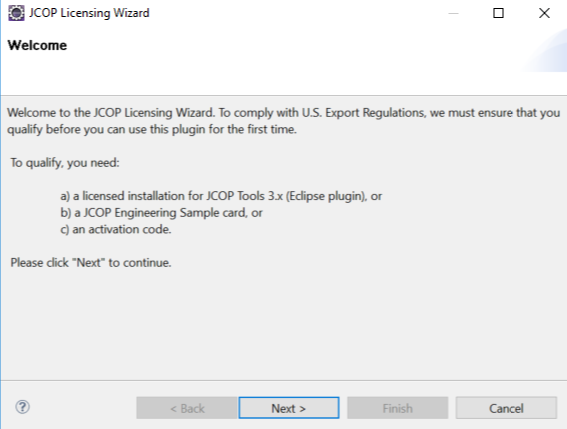

I'm having trouble with the accessing the JCOP 3 licensing wizard to activate our JCOP tools. The wizard doesn't show if I try to create a new project. I have the Oracle JCDK 3.1 installed and it also uses a Java Card Project wizard. But I have to assume that the JCOP tools use a separate wizard. At any rate, there isn't a separate folder showing for the JCOP tools. Can you assist in getting this corrected. The version of eclipse that I am using is 4.8.

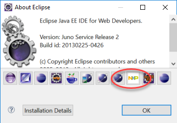

I understand your concerns, and I have reproduced your issue on 4.8 version, looks like it is due to eclipse version, cause when I use 4.3 instead, the plugins can be installed properly, and the license wizard comes out as expected.
You may download the 4.3 EE version from the following link:
https://www.eclipse.org/downloads/download.php?file=/technology/epp/downloads/release/juno/SR2/eclip...
and after successfully installation, you may see "NXP" as below.
Please note I didn't install any JCDK 3.1 on my laptop. Please follow the prerequisites requirements listed in JCOP_Tools_Getting_Started .pdf. and my java version info is as below:
