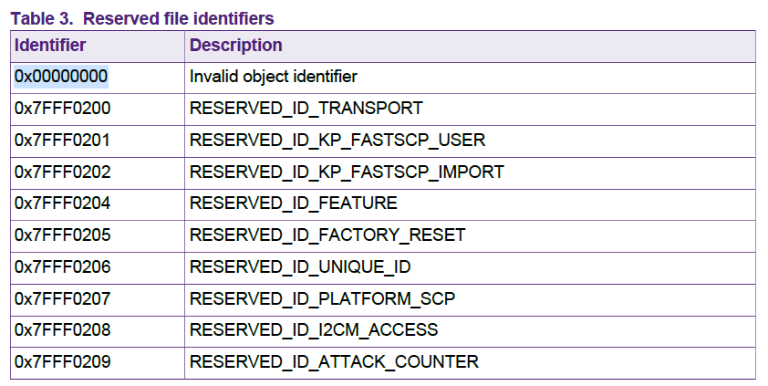

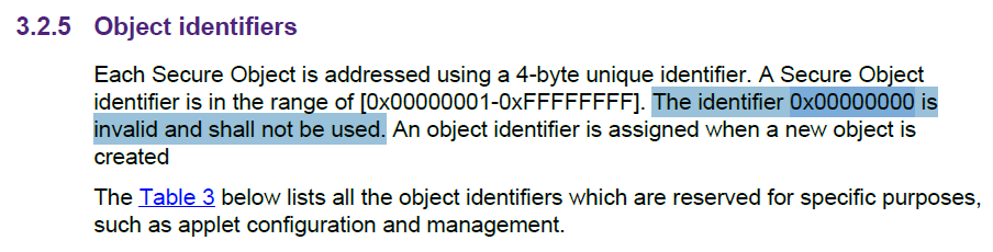

4,713 Views
Kan_Li
Hi Markus,
This define is recommended to be used for readability.but functionally it serves no further purpose. The spec is right, you can not use the id "0x000000" for auth. Please kindly refer to the following for more details.
Hope that makes sense,
Kan
